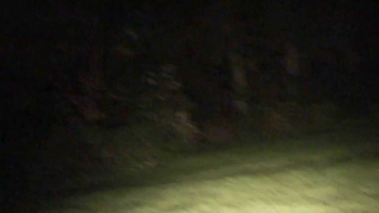

I just came in from shooting the video, you all must understand how hard it is to drive a zero turn with one hand while holding a camera in the other. You really need 2 hands to move each stick! Tomorrow night I will shoot some beam shots while off the mower!
Magic!!! Thanks for doing the vid
The lighting looks very adequate (but I do not mow lawns)

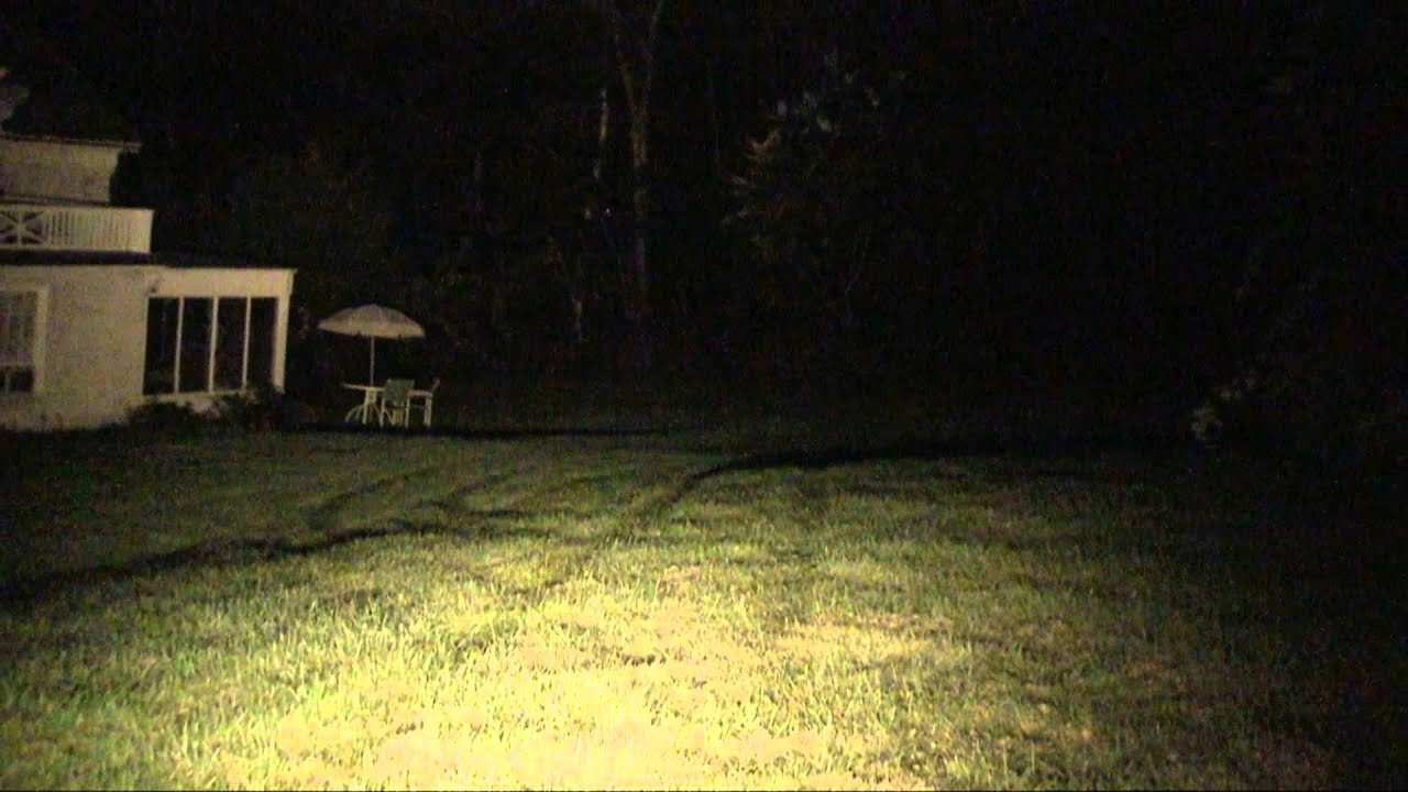

Nice videos! More output than I expected too, although the beam seems a little narrow (or at least a little narrower than I'm working toward - still very useable though). Looks warm (actually like a neutral tint that's close to the warm side) and good for seeing detail. Do you feel the videos show the output correctly? Does what we see in the videos accurately represent what you saw with your own eyes? Seems your two housings could probably even be spread apart further to widen the hotspot. That or tilt them away from each other very slightly.

Looks good. Do you intend to aim them higher? Seems like the hot spot is too intense that close up.
It only looks like they are pointed downwards! :bigsmile:
What you see is SPILL, my son, SPILL :bigsmile:

Seriously though, Garry is right, I have more work to do to get the beam pattern right. Now it is conical and that is not good for a lawn mower.

Now I’m thinking that in addition to installing the “bezels” to point the 2 outermost bulbs a little to the left and right, I have to install some kind of reflective “eyebrow” over each pair. Any ideas on that, anyone?

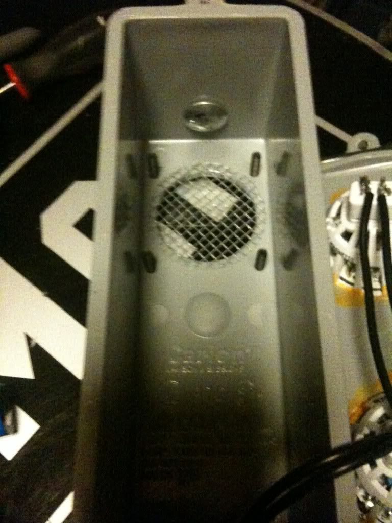

Installed the fan and filters today. A simple job like that took much to long. I couldn’t find my tools, the shop is much too messy! I was going to mow the lawn today but instead I really must cleanup the shop.
Oh wait, I can mow the lawn tonight! :bigsmile:
Nice air filter solution. Congrats

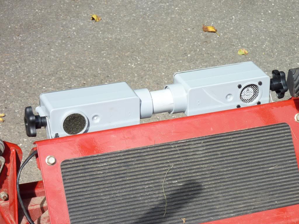

Here is a picture of my gasoline powered - self propelled - rolling flashlight, about to be cleaned and put to bed for the winter. :smiley:
The 4 MR16’s with 8 Nichia 119’s each on top and 4 XM-L’s on the bottom. Notice the tint difference between the Nichia’s and the XM-L’s
