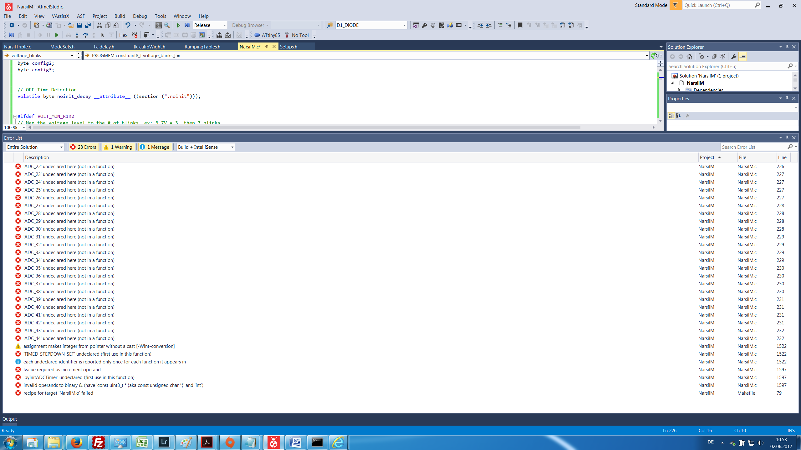

so first try to compile NarsilM for TA triple board using R1/R2 reference
I got a ton of errors

I uncommented 360k
but those
TIMED_STEPDOWN_SET
byInitADCTimer
errors are still there
The only way I see 'byInitADCTimer' is undeclared is if you commented out VOLTAGE_MON:
#define VOLTAGE_MON // Comment out to disable - ramp down and eventual shutoff when battery is low
Is it commented out? Commenting out disables stuff, but not everything I see. I'll have to see about fixing that. I've never built firmware without LVP, so not sure why you'd want to do that.
I commented this out as I thought its ok when I enable R1/R2
one error still there
Severity Code Description Project File Line
Error ‘TIMED_STEPDOWN_SET’ undeclared (first use in this function) NarsilM B:\Bilder\Export\Flashlight\NarsilMulti\NarsilM.c 1522
Message each undeclared identifier is reported only once for each function it appears in NarsilM B:\Bilder\Export\Flashlight\NarsilMulti\NarsilM.c 1522
Ok, so far so good.
The TIMED_STEPDOWN_SET is defined in the RampingTables.h file. Could it some how got deleted or commented out? It's needed. I see it's there for two 3 channel table definitions, so should work. Did you add in your own table? If so, maybe you left out the TIMED_STEPDOWN_SET #define?
I just copied that ramping table I posted above in the ramping table file
it seems that in previous Narsil it was defined as TURBO_DROP_SET
changing it to TIMED_STEPDOWN_SET compiles the project
