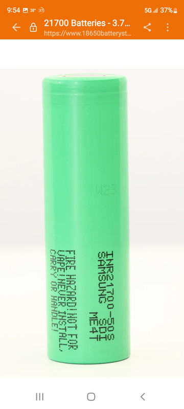

Does anyone know how to read the manufacturer code on these batteries.
I saw YouTube video and it was a different language and the guy was going so fast it was so hard to follow!
It’s not in the data sheet. An example of the number from 18650 battery store is.
ME4T
Photo courtesy of 18650 battery store
I watched several more times I think I figured it out.
M=Year 2022
E= Month Februry
4= 4th week of month
T = the Factory in China…Tianjing
:+1:
