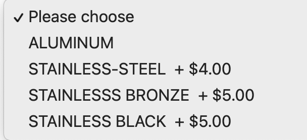

Will the KR1AA have stainless / copper bezel options?
What about making alternate bezels that are taller and having a reflector or deeper TIR option for more throw?
yes stainless and also a couple of PVD colored stainless options listed on Jacksons site:
And Jackson might be getting a shipment next week, of the prototype run without the physical lockout option
