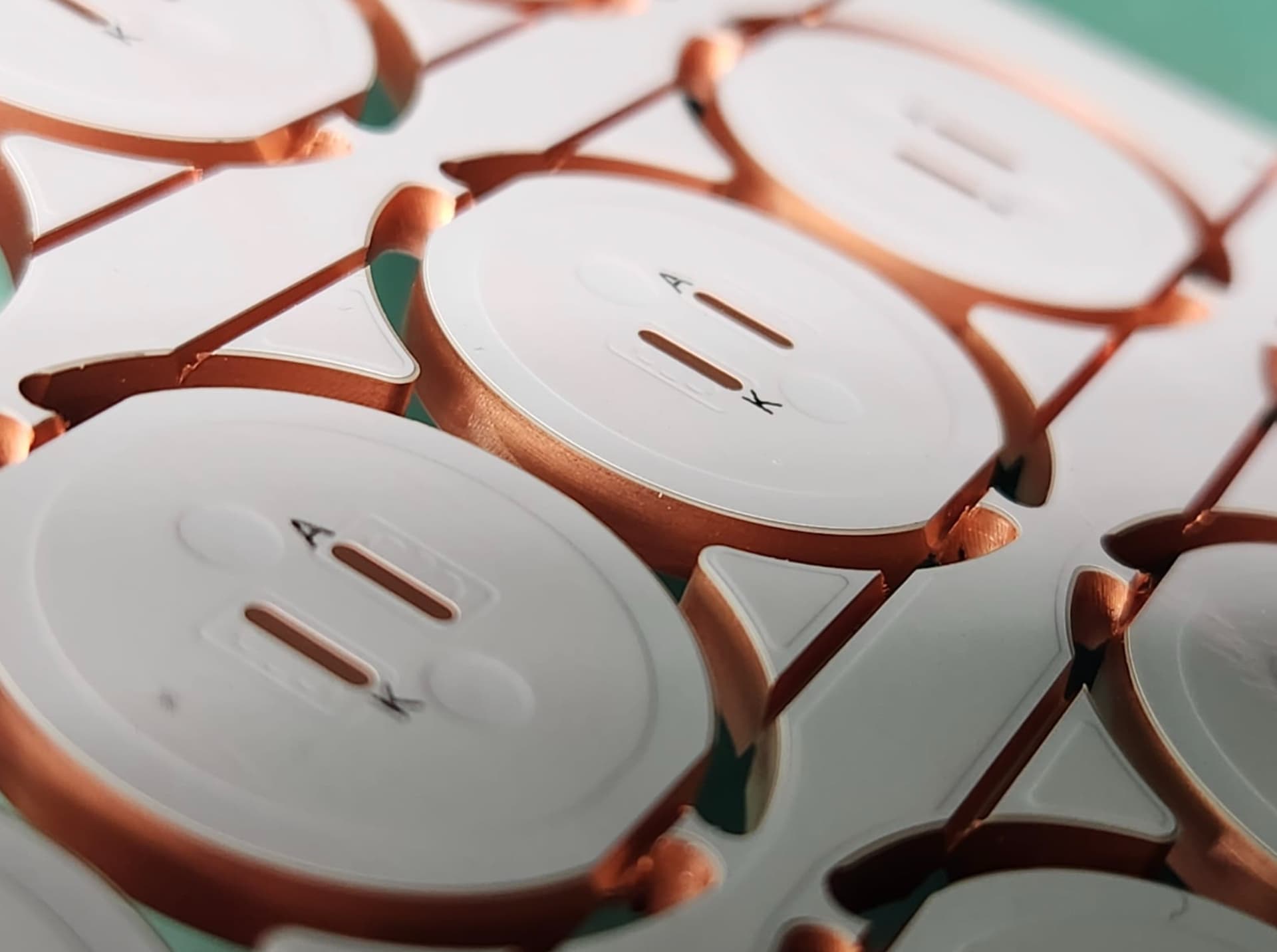

Is this that board shown in this pic?
Maybe I can modify it slightly to fit it to my heatsink (drilling screwing holes for proper mounting).
Yes, is this board. For testing you can ignore everything other than V+ and V-(Main power path for the LED). The Aux input and NTC connector is some reserved stuff for my driver. Also I will send a 3D printed drill template combined with the LED for easier installation.

Since this LED uses a special footprint I have to design my own MCPCB (in standard 20 mm size) what I have not done so far. So at least I would have to deal with the available boards for this LED anyway.
currently I’m not gonna to fab small size MCPCB for this LED because it’s meaning-less.

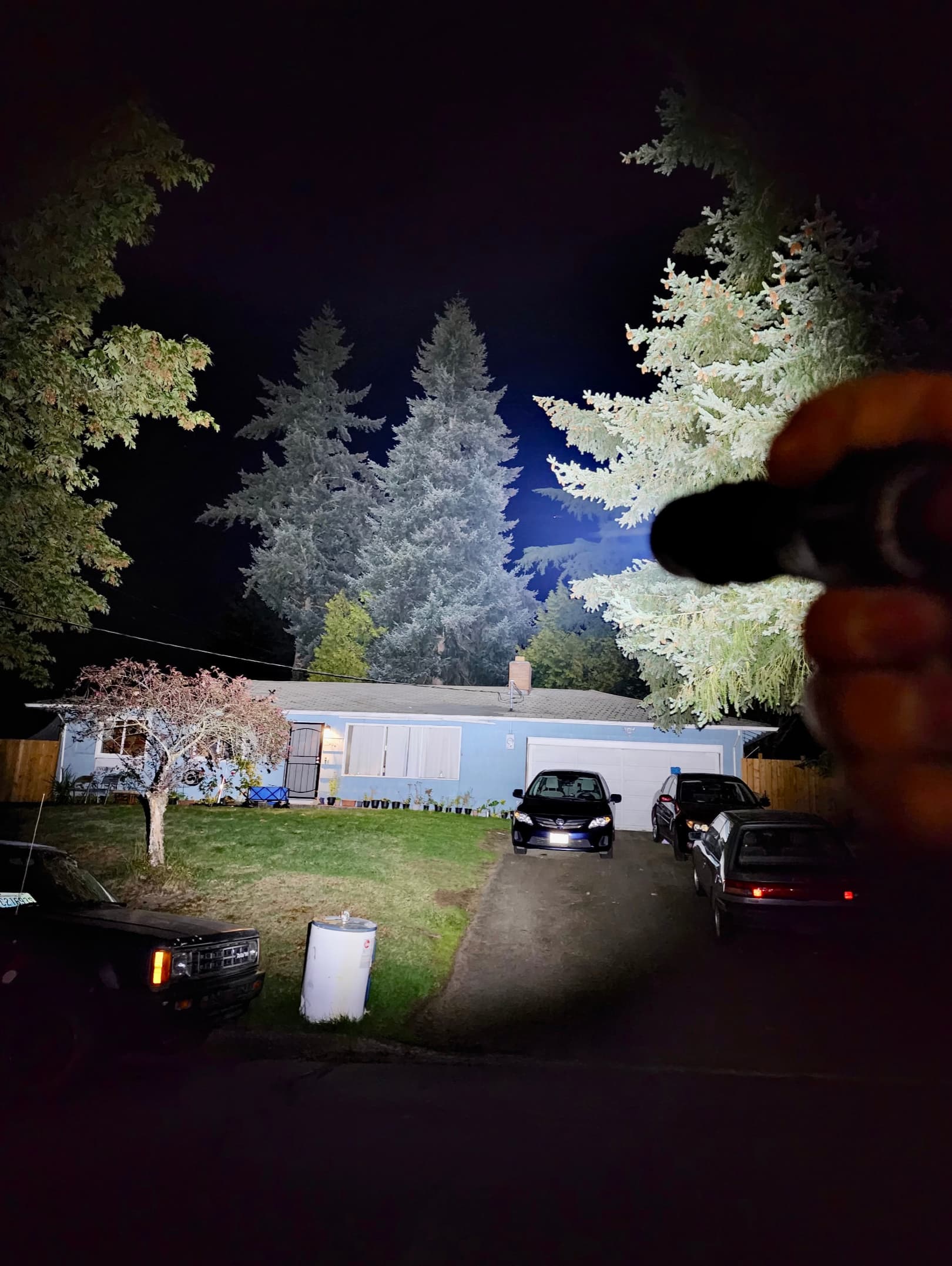

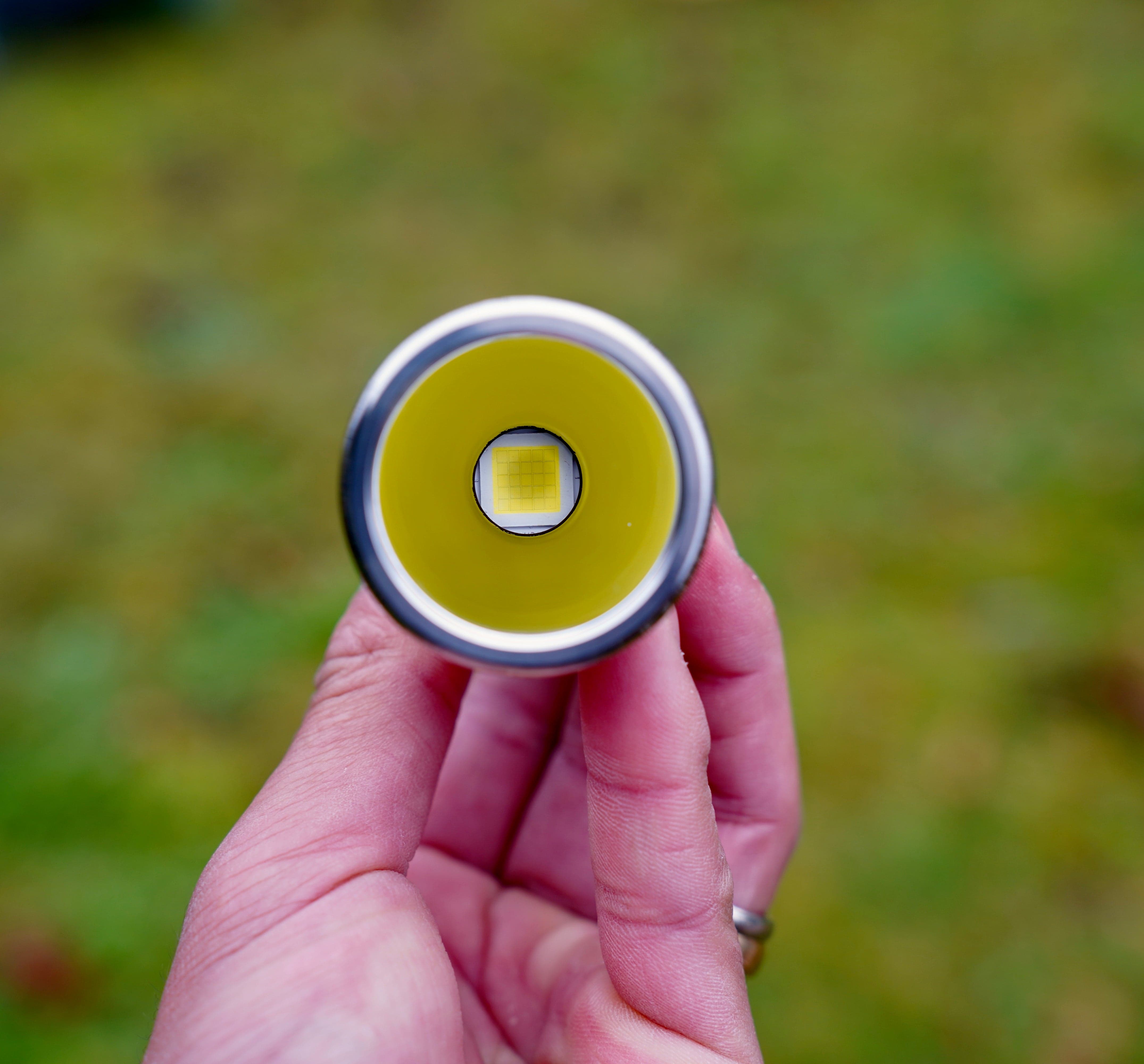

And as far as putting a big led in a small host being pointless I disagree, it actually works pretty good.
Narrow reflector, yet the beam is perfect no annoying hotspot

Looks like a T8vn+ with a 5x5? is the emitter an SFP55?
The photos I posted are not the led the op is talking about
The photos are from skylumen website

The point of me posting those pics was to demonstrate that a big led can fit into a narrow host
