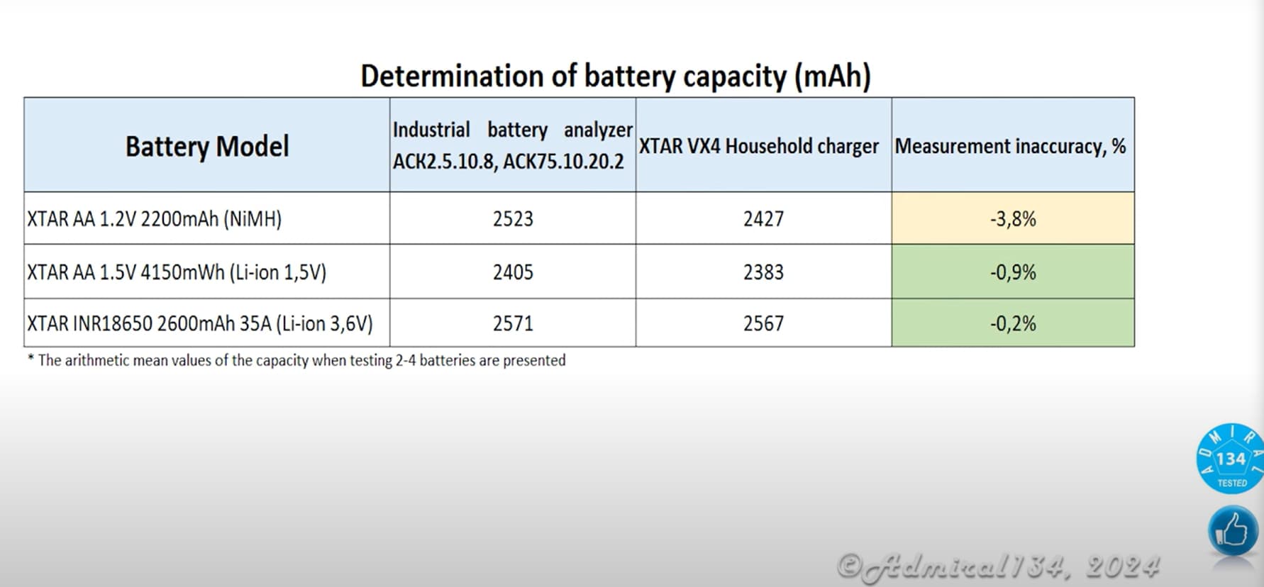

【Updated】The capacity grading accuracy of the VX4 charger
The VX4 charger uses a 300mA discharge current to test battery capacity. Compared with a professional capacity grading machine, its energy and capacity test accuracy is more than 95%. Under the comparison test of the XTAR lab, with the same test condition, a randomly picked XTAR 1.5V AA 1200mWh battery had real capacity 1161mWh by VX4 charger, and 1129mWh by capacity grading machine. The accuracy error between them is less than 3%.
And there is the VX4 real test by Admiral134 as below.

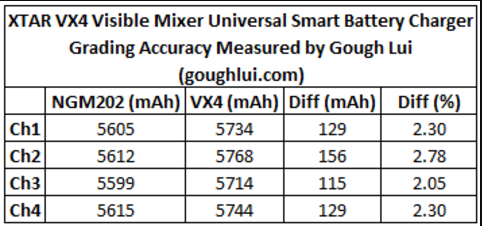

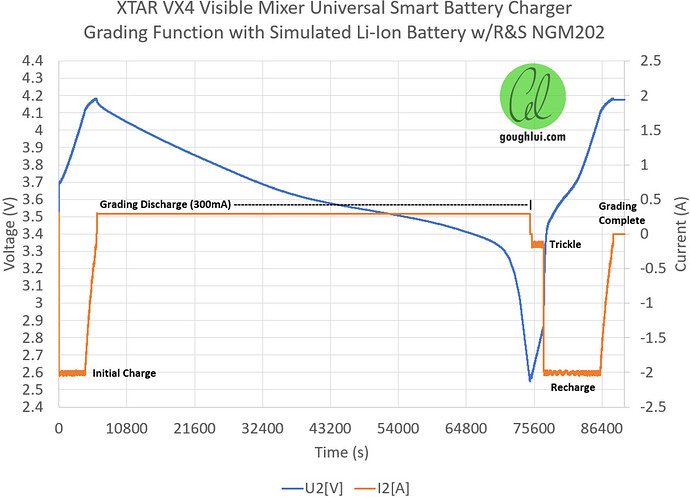

【Updated】XTAR VX4 Charger Review by Dr. Gough Lui
Thanks Dr. Gough Lui for the thorough review on the VX4 charger. “The XTAR VX4 is a very competent charger that can handle all commonly used rechargeable batteries. It reliably detects and handles 3.6/3.7V Li-Ion, 1.5V Li-Ion and Ni-MH automatically, allowing for a mixture of types of cells to be charged at the same time. The Grading results on the VX4 are within 2.0-2.8% (overestimate) of my lab-grade Rohde & Schwarz NGM202 which is sufficiently accurate for basic checks…”
Please check more details online:
VX4 TEST 2
That’s an excellent review! Very detailed. I learnt something new. :slight_smile:
i.e. 2% overestimate for capacity. Power supply with 12V output should be used for optimal performance. An adapter with PD might change to 9V.
