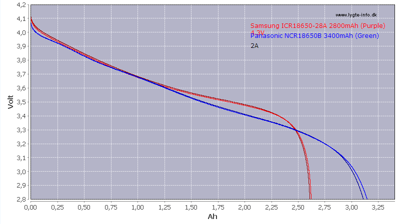

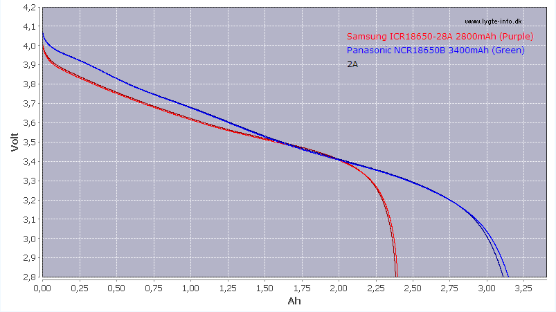

Just for grins I decided to post the graphs here of the two batteries compared.
Samsung charged to 4.2 volts. Panasonic better for the entire discharge.
Samsung charged to 4.3 volts. Voltage is higher until 3.3volts is reached, then the Panny is higher. At 3.3 you will not be pushing an XML hard anyways.
If those charts indicate the performance I should be seeing from the recycled Samsungs, then mine seem like old, tired cells.
Is there a way to find out if they’re even safe to use at this point? I’ve been using them just after charging them, but now I’m wondering how long they’ll even hold the 4.2 volt charge while just sitting around. Guess I need to find my old DMM and take measurements.
