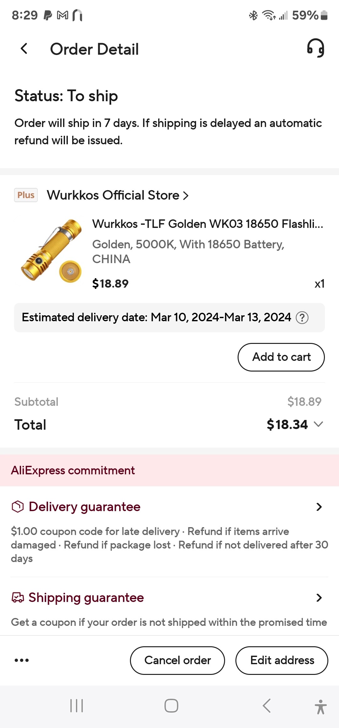

I ordered one for 20.66 €.
After a few minutes I get in my coin discount finder offer to purchase it for 16.86 € but I have already buy it for higher price

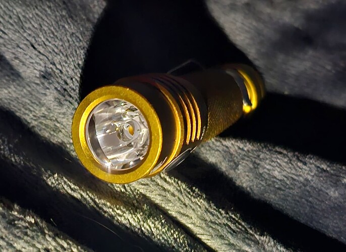

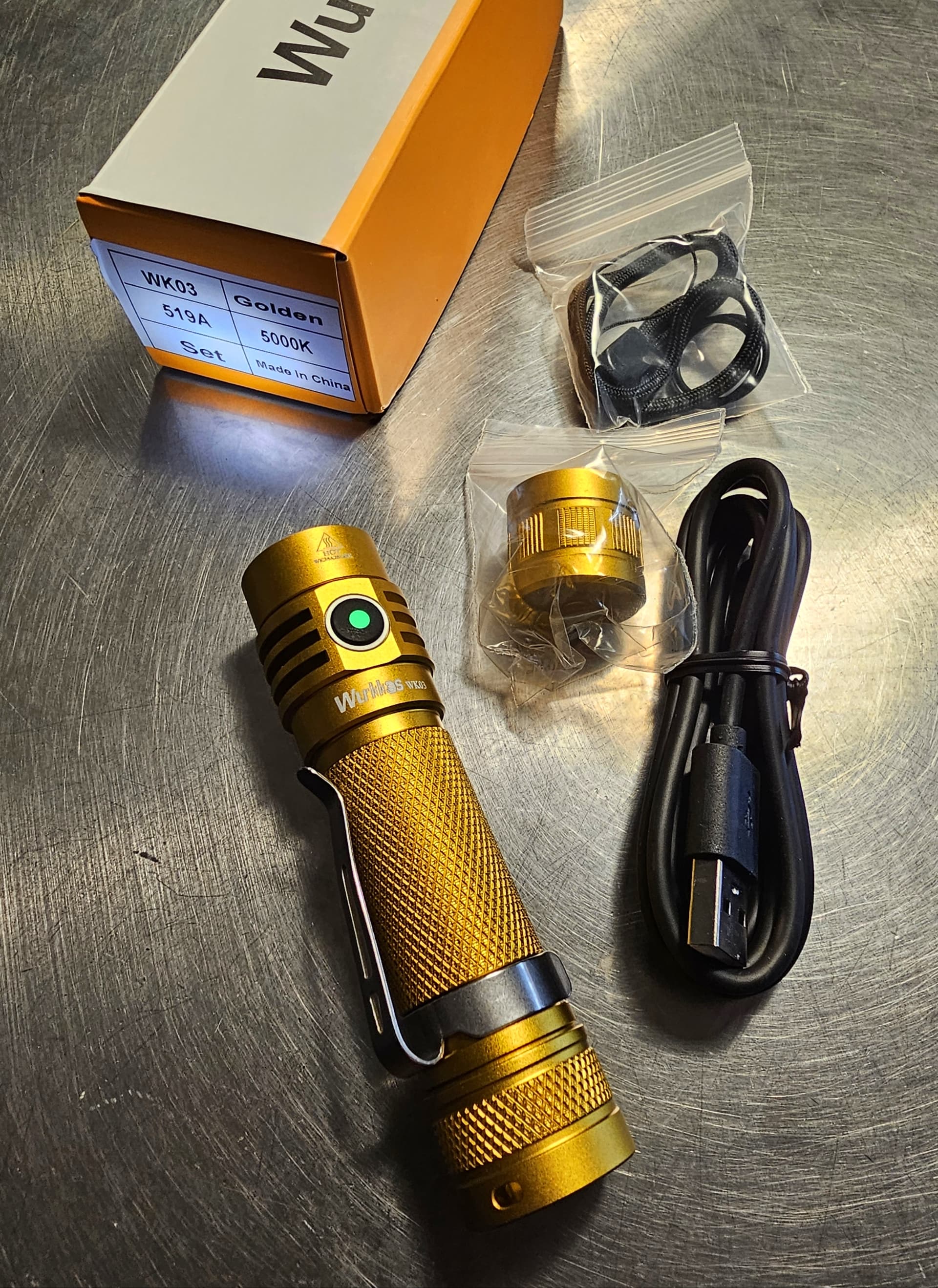

Meanwhile I also recieved my ‘Golden’ WK03 and so far I really like it!
Simple UI, but sometimes that is a nice change too, instead of (very) ‘complicated’ UI’s all the time. I certainly like the used 5000K 519A; my first thought was that is felt as pretty ‘cool white’, but after using the flashlight a bit I actually like the nice and neutral tint and as weklund already stated: no (noticable) green tint!
So all in all a nice value for money, certainly if you regard the fact that the 3000mAh battery and magnetic tailcap are included. It also is still pretty bright on Turbo, when I compare it to it’s (almost) “identical twin” from Sofirn (the SC18), which has a slightly brighter (cool white) SST-40, but the 519A is superior in almost every way, certainly when you have them side by side.
So yeah, very happy with it; a straight forward/no-nonsense and compact (18650) flashlight, which is great for every day use in and around the house!

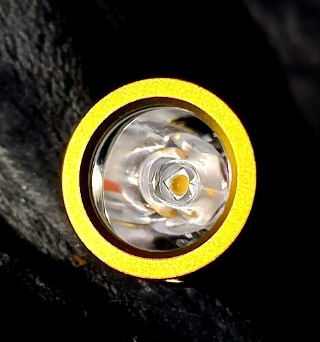

Mine showed up yesterday, and I totally concur with all your sentiments. The emitter seems to be a more ‘rosy’ bin than the one in my FC11, very pleasant. The beam profile is excellent with the smooth reflector, with no discernable artifacts. Great value.
Thanks to OP for sharing this offering.
Ha! I didn’t even notice that. It’s so clear I thought it was a standard reflector. My eyes aren’t so good anymore. One reason I shy away from modding.

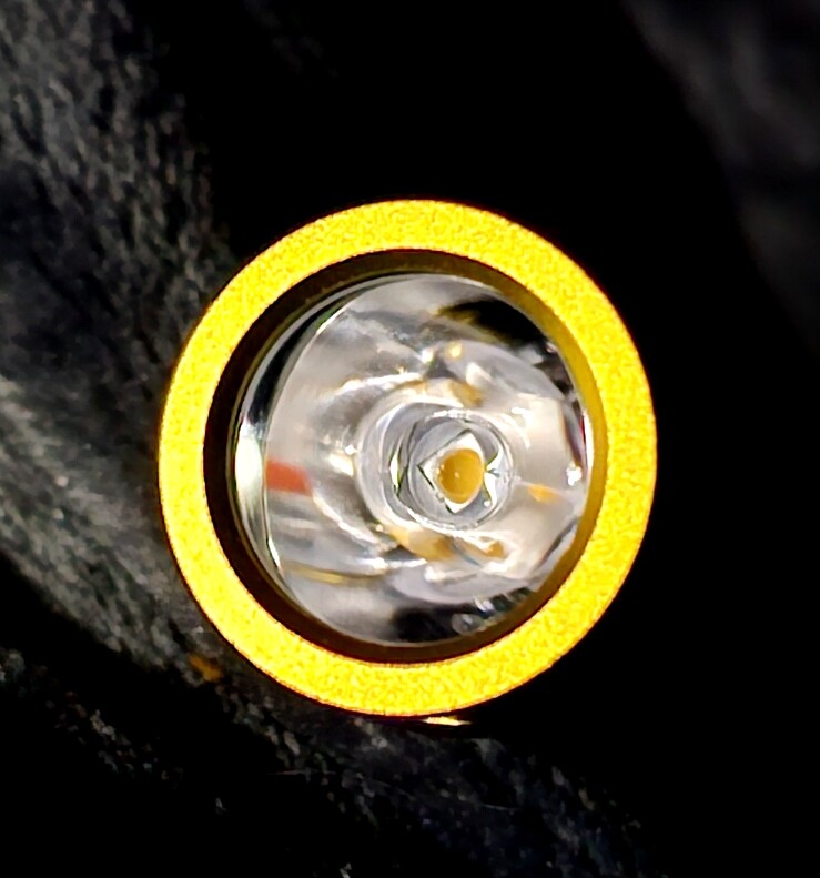

I don’t have a ‘regular’ WK03 to compare it to, but assuming that the Sofirn SC18 was/is roughly the same in terms of used parts (and also the TIR), then it seems to be that they’ve used a different TIR in the ‘golden WK03’.
When doing a (white wall) beamshot comparisson between the SC18 (SST-40) and the WK03 (519A), I expected the SC18 to have a bigger hot spot than the WK03, due to the bigger ‘LES’ of the SST-40, but in practice the ‘golden WK03’ has a noticably bigger hot spot than the SC18. The hot spot is also noticably more defined (sharper/harder edge) than the SC18, which has a hot spot with a quite soft edge.
Maybe the dome of the 519A (in the WK03) also plays a role in this, but given the fact that the difference is quite substantial, I also feel that they used a different TIR with a wider angle.
