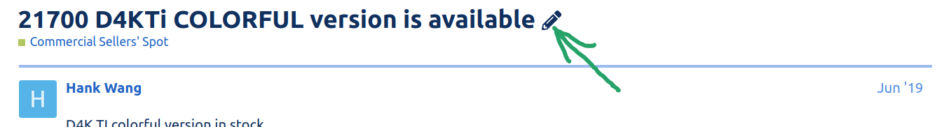

I actually have not been able to figure out how to update the title for the new BLF site.
Just click on the pencil icon (“edit this post”) at the bottom of the original post, and edit the title. :+1:

The “edit this post” icon is in a different location for my threads. :thinking:
It’s the edit title button, but yes the title can also be changed when editing the first post.
