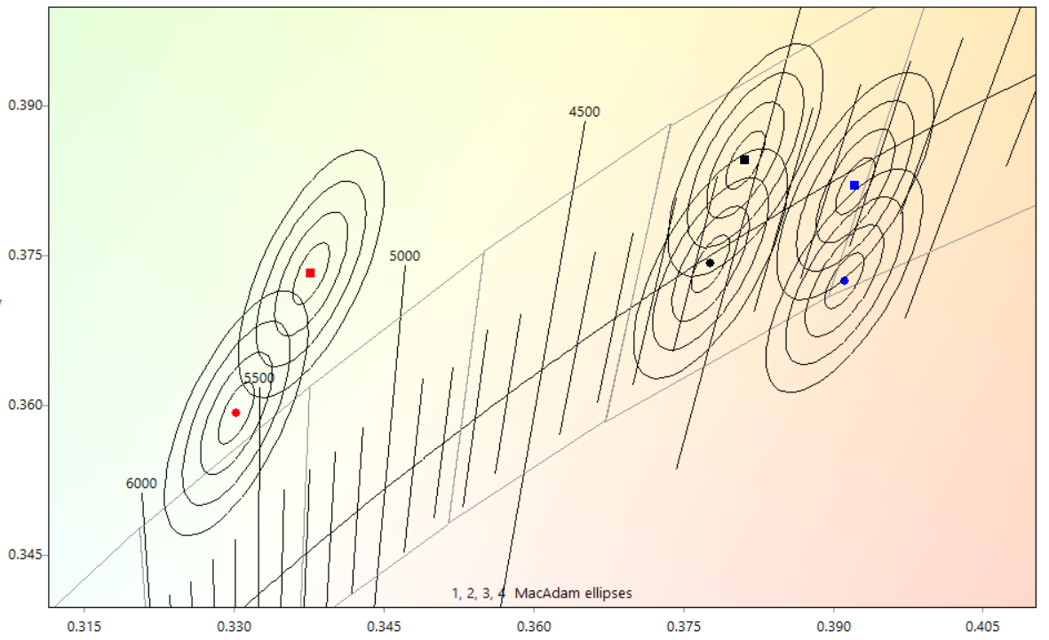

Coming back to the opple, and especially duv measurements comparing Sekonic VS Opple :
(Taken for the 1st 3 measurements in Cheule’s video, circle is sekonic, square is opple)
So the opple measurements are 4~5step, 1 step (1st circle) would be visually indistinguishable, 4~5step is quite a big difference, if you were to use this measurements you would say that the black one is a bit greenish, but it’s actually neutral, the red one neutral, but actually rosy. This data is not good enough to qualify the tint of those lights. That’s what Correlux an Royoui are saying. In my opinion it would start to be usable if it was within 2 step.
Do you know how much DUV can change depending on how you measure? What mode it is in, how long the light is turned on, etc?
So many variables..
And how about CCT? or CRI?
You don't think the Opple could be used for those?

Yes, duv measurements can vary based on variables such as current and angle. However, the point I am trying to make is that duv calculations based on the Opple’s data are not very accurate to the light that is hitting its sensor. A spectrometer like the Sekonic or Hopoocolor will display variability, but will at least give you an accurate reading of the incident light.
If you place a spectrometer and the Opple in the exact same position in a carefully controlled environment, the Opple’s data (particularly duv calculations) will be quite inaccurate when compared with the spectrometer. It simply was not designed for these kinds of quantitative measurements.

You are describing a qualitative comparison, and in that regard, the Opple would work perfectly fine for those kinds of comparisons. However, the actual numerical duv values you are seeing won’t be very accurate.
I understand your commentl, and I agree. However, there is a lack of relevance of “accurate” measurements, due to LED variation. If people expect to look at Sekonic data online, hoping it will be true for their LED at home, they have UnRealistic Expectations.
