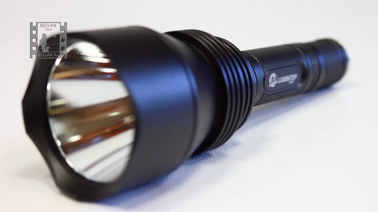

For something off-the-shelf, the Lumintop T5 Hunter looks really nice. Came reeeaally close to nabbing one. Like the proportions of it, and of course, xpg2.
THIS review is positive.
Here’s a vid:
There was a seller on ebay selling for $65 a month or two ago.
Yep that’s my pick too.
