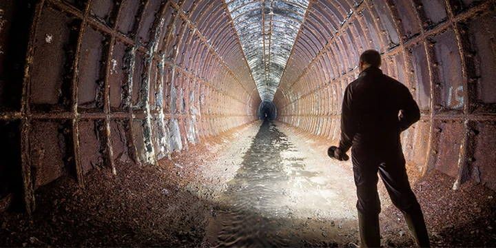

If all you’re doing is shining the hotspot fairly close to you, ie, for walking, where the spill lights up what’s immediately in front of you, and the hotspot lights up the path maybe 20’-50’ ahead, then that’s fine.
But if you’re using the light to look at something in a forest, tunnel, dark tree-lined path, etc., forget it. You’ll be lighting up the trees right in front of you or the sides of the tunnel, and what’s way down yonder will be in the dark.
Ever see things like flash pictures taken at a wedding venue, etc., where the people are well-lit, but the background is dark if not completely black? That’s the effect I’m referring to. Reviews of throwers have plenty of beamshots of exactly that. “Something moving between those trees? Let’s have a look!” So you light it up, see brightly lit trees all around, but what’s in that hole stays in the dark.
I just grabbed a random pic of a tunnel (so much for goggling “flashlight illuminate tree lined path”…) that shows this.
So you can have a machete-wielding psycho killer rushing at you from the other end of the tunnel (maybe that teeny spot in the middle?) but all you can see is the walls of the tunnel, thanks to the “useful spill”.
Try that with a LEP or something, and you’ll see the machete-wielding psycho killer just fine.
Hell, I could probably see what’s down that hole better with my Cat Mini and its whopping 500 lemons than that big honkin’ light used in the tunnel pic.
Exactly - I’m glad now you understand how a spill is useful in a walk light. That’s why I had that gentle reminder: “speak for yourself.”
Just a “random” picture of a guy in a SMALL TUNNEL to emphasize brightness, with some “random” flashlight that might just be the brightest flooder one could find. Thanks for the good laugh that’s actually pretty funny. I hope you’re not serious. :sweat_smile:
