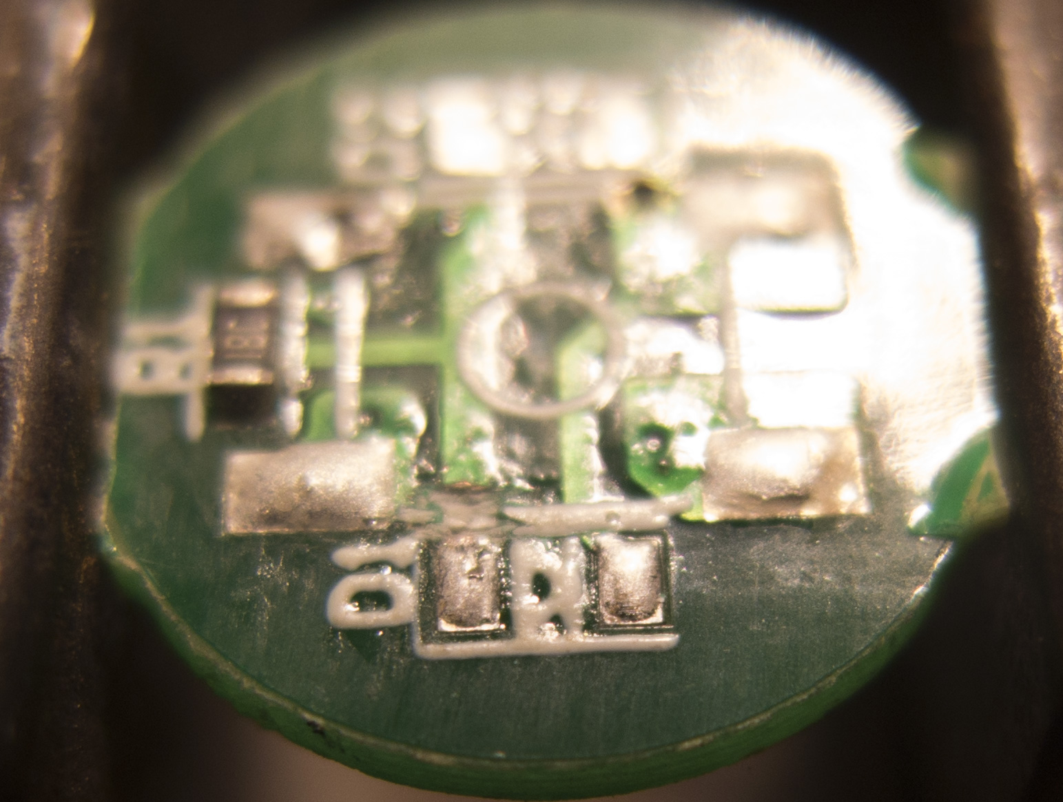

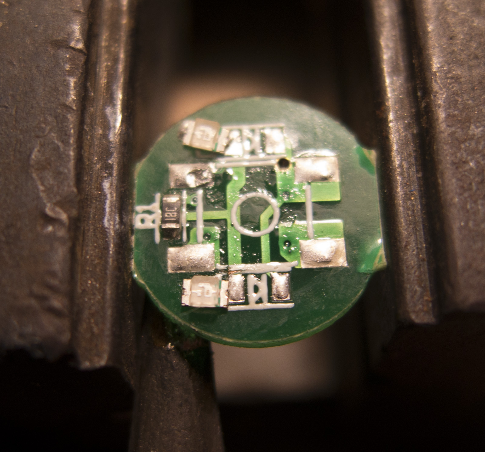

side switch board modified to even out the LED brightness
Cree LEDs of the same reel usually have quite the same Vf,
but for those tiny SMD LEDs the emitting area is a lot smaller, so they may vary a lot more
Unsoldered LEDs and switch just holding my temp stabilized iron at 300°C at the other side
also skillet might work well
then cut the trace to one LED and add a resistor
add solder paste
add resistor and wire
2 white LEDs with 19.1kOhms each
