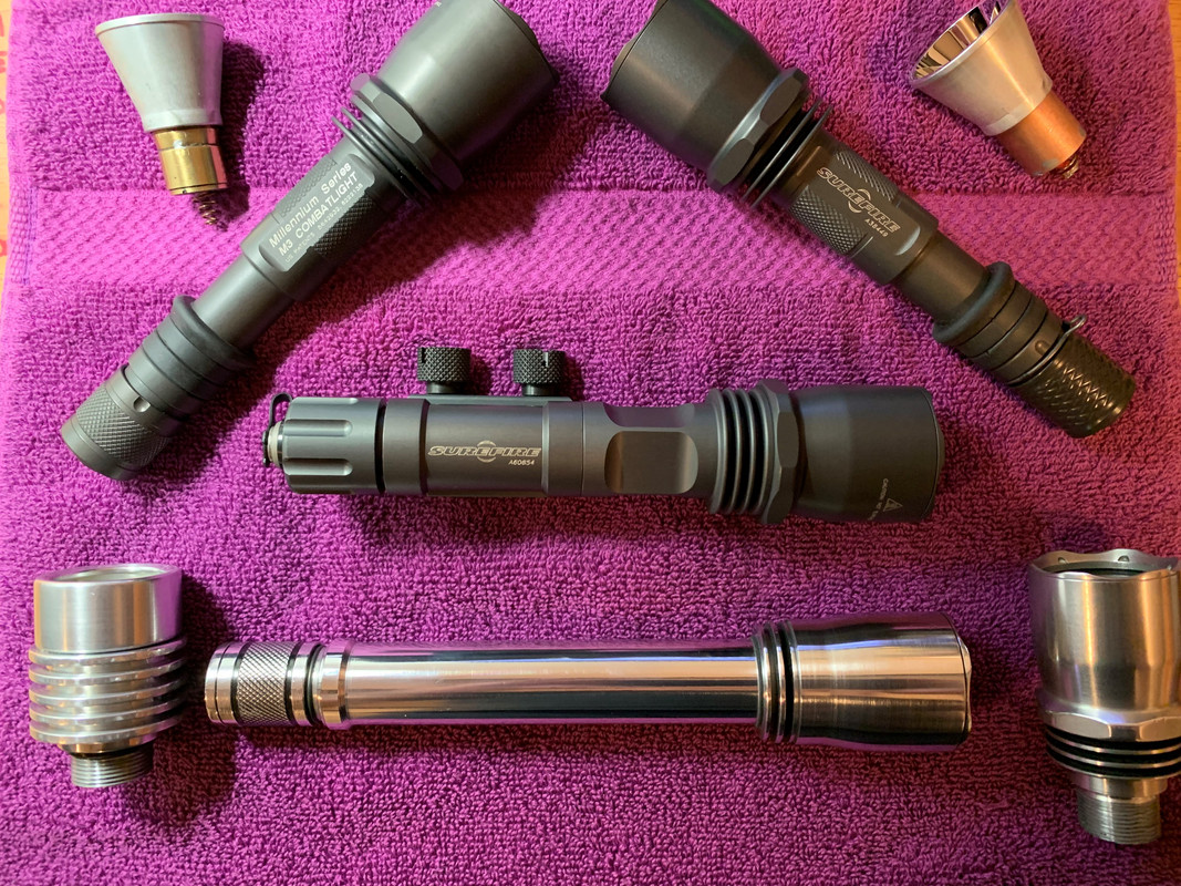

These also…. but I have different drop in’s I made…to interchange depending on what the need may be…
The polished M3 is custom made to accept screw in heads/modules, fully potted…. the 70.2 is making just over 8000lm at turn on….
6700lms on 2xAspires…

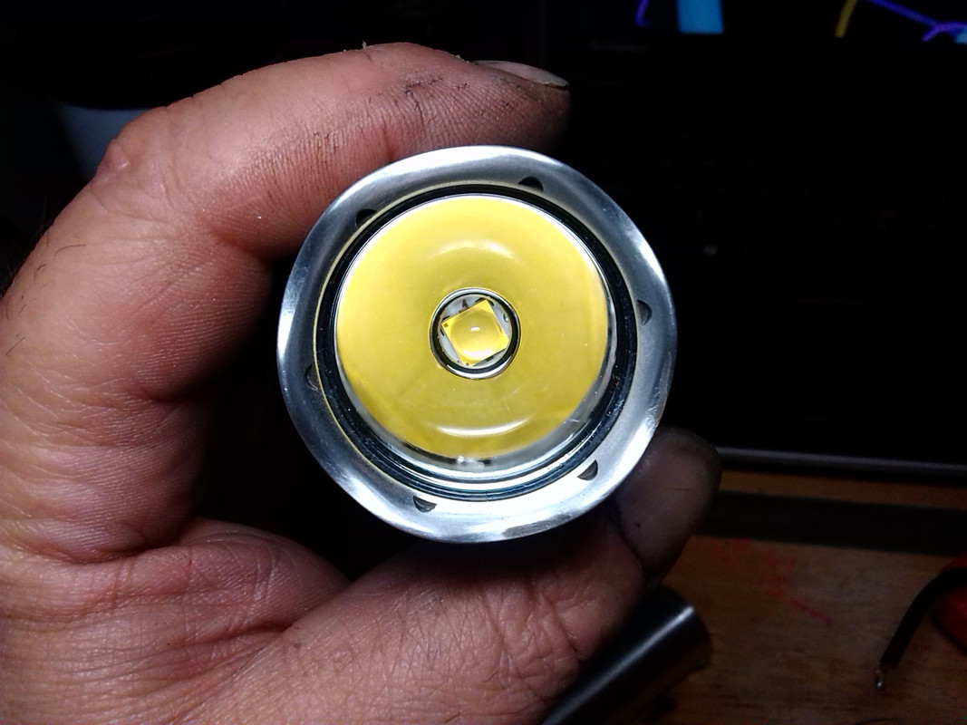

My latest 6P mod, bored/honed, hand fit press fit copper quad pill Lumileds V2 2x5000k x 2x6500k….
4500lm+ on VTC5A more on a 20S VTC5D nice tint, nice output…
