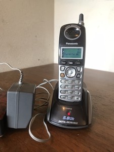

Do the older Panasonics have intelligent chargers? eg. PQLV30030ZAM like this:

The Panasonic set I’m familiar with seems to have ‘intelligent’ charging. I’m unsure of its age, but the handsets use AAA cells.
Occasionally, a handset sitting on a charger will chirp and indicate ‘Charging’ on the display. This leads me to think that they aren’t constantly being charged while on the bases. Does your set do that?
Oh… good point. The handset does actually display “Charging” and then “Charge complete” while on the charger, though the charger’s red “Charge” light always remains lit while there is contact.
Forget reading the manual, sometimes just reading the handset’s display will do!
With my Panny phones (model KX-TGA641) if the batteries have been removed/replaced when you put the handset on the charger they appear to get a full charge even if the batteries were already charged (like by an external charger) so be careful.
+1. My Pana KX-TG6445T phones, which accept standard AAA NiMH cells, do not appear to have intelligent charging and wear down cells more quickly than I would expect. If you remove/replace the cells, they will always be charged for many hours as though it’s simply a timer system, though the phones do have some concept of “charging” and “fully charged”.
