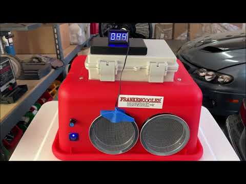

I was looking at all sorts of portable ac units to cool the back of my work van for the summer.
I use the back of my van (weather permitting) as a place to retreat and catch a nap before I have to go back to the shop.
I can`t run the AC all day in the van because of GPS.
I found `Frankencooler` on a google search and was thinking of picking one up and then I found a bunch of other links on youtube where I can make my own for cheaper. I`m going to try and make my own but I`m not sure how well it`s going to work.
Again, these types of coolers work off of ice, which I can get a butt load of at my shop every day.

There are such things as two stage coolers.
The ice or evaporative portion is used to cool a secondary loop.
The moist air exits the cooler and is not used to cool the inside air.
The secondary loop cools the inside air. Usually recirculated.
This loop will pull humidity out of the system.
Commercial versions are expensive.
Going to need a pile of ice to last any length of time.
Still there are refrigerated units made for campers.
Unless you want to play, why reinvent the wheel?

I can get plenty of ice from work. I need something portable and works off a battery.
Like I said earlier I can`t run the AC in my work truck for extended periods of time since my company monitors truck usage (we have the worst performing hybrids ever lol).
I was interested in the Ecoflow but by the time it comes out and the reviews are in the summer will be almost over lol

@ftumch33: Modified ice coolers are commonly used in general aviation and work quite well for the purpose. The biggest issue youâll run into is that melting 1 lb of ice only gives you 144 BTUs. A cheap window AC is rated for 5,000 BTUs per hour. Most RV rooftop ACs are around 13,500 BTUs/hr. So for something equivalent to a window AC, youâd need 35 lbs of ice per hour. To match the RV AC, youâd need 94 lbs of ice per hour.
Depending on your work truck, this might work out fine. Use it for spot cooling instead of room cooling to reduce how much ice youâll need, ie: have its output as close to you as possible. In the plane these normally get tossed in the rear seat and ducts are usually set right behind the pilotâs neck. We only use them for taxi, take-off, climb-out, then descending & taxiing at the destination, or about 30-45 minutes of runtime. Even in Florida, cruise altitudes usually are cool and dry enough to be comfortable.

You got me interested in this.
The Frankencooler - the official one - looks to be just what you are looking for.
The Blowbox Twin is the one I like.
An ice chest that cools a radiator that cools the air. And doesnât pump moist air from the cooler into the system.
Like others do - Icybreeze and most of the home built ones.
No need for any outside air sources.
Kind of expensive for the twin blower kit, but looks like itâs made for your application.
You could likely put one together for a lot less, still it looks like this guy is putting out a quality product.

I was thinking of buying the plans.
20 bucks is pretty inexpensive and I could probably do the rest as far as acquiring what I need and putting it together.
One of his videos on youtube, he kind of gives you the layout of how he started to build his so I`m not even sure I need to buy the plans ![]()
I wonder how easy it is to disassemble that red box from the cooler. If not, youâre going to have major mold & mildew issues.
Yeah, I think the only hard part is finding a radiator the right size with enough surface area.
I like the idea that the heat exchanger can be completely separate from the ice chest.
Everything else is a few Amazon clicks away.
