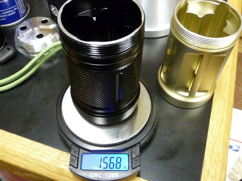

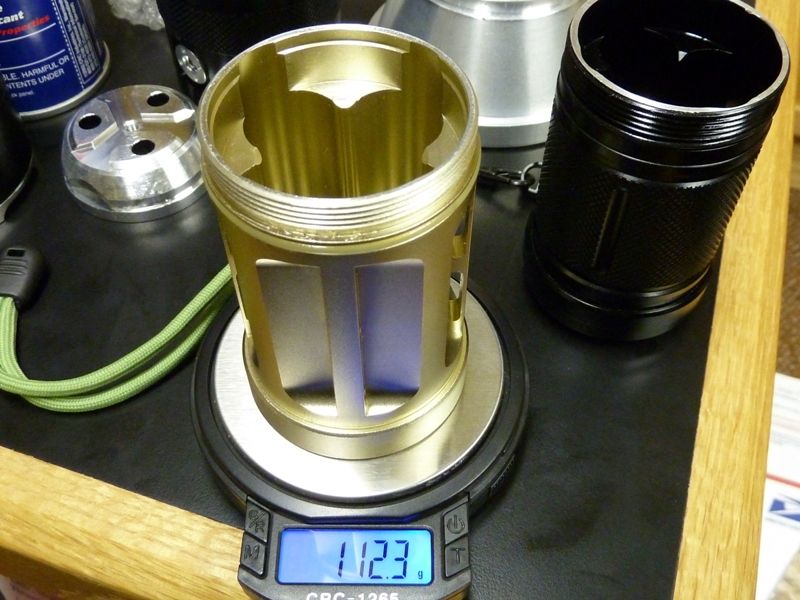

Here's a comparison view of the thickness of the battery compartment compared to good quality SRK (FF UV-S5):
Weights:
