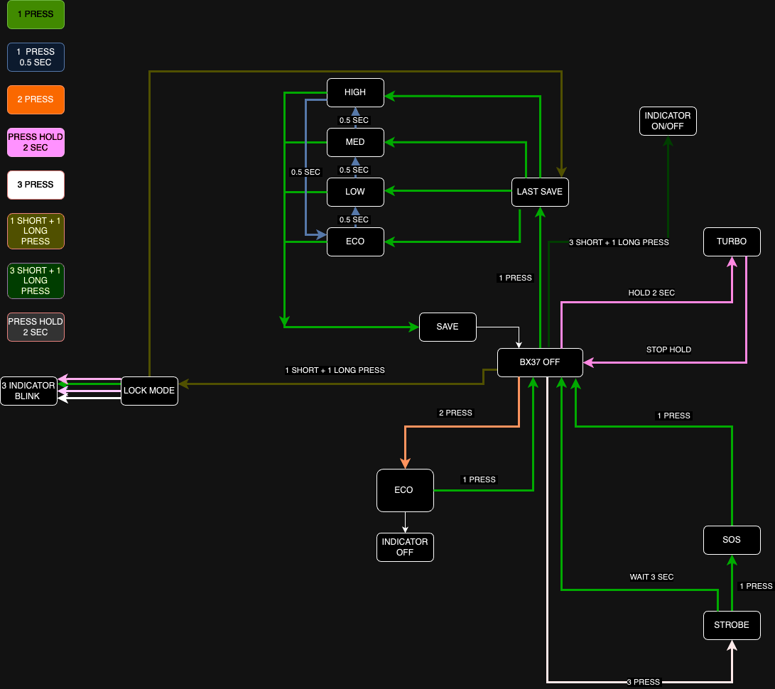

- 2C activation is made to avoid accidental activation in a backpack. And also not to create a lock mode. Most users rarely use the lock mode.
- 1 sec hold causes temporary turbo. as soon as you release the button, the flashlight turns off.

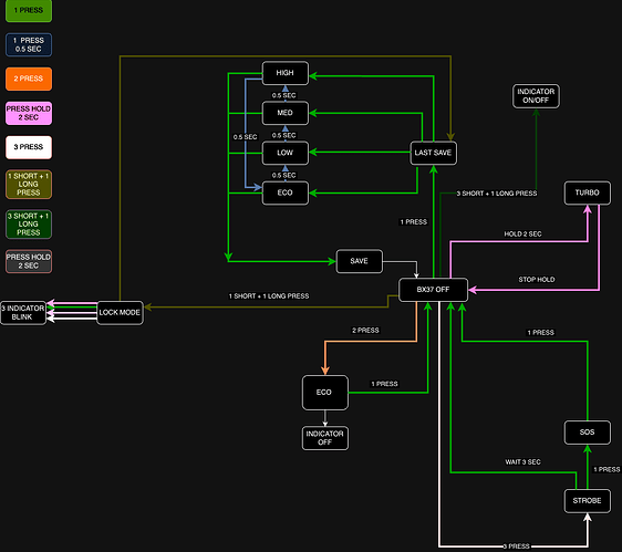

- Change of operating modes is changed by holding 0.5 seconds. You can see it in the schematic.
- Turn off is 1 click. The green line is 1 click.
- Strobe turns off with one click, after waiting 3 seconds. If you press before 3 seconds, it goes to SOS.
- We have ECO mod - 15 lumens. This is enough to run for up to 10 days on battery power.
- Two different off are made to show that one press does not turn the flashlight on.

The point of a lockout mode is that it’s optional. 2C every time you want to switch the light on will get annoying fast. On almost every light, 2C is turbo, and 1H is low/moon. Having 2C be normal on and 1H be turbo is going to cause a lot of confusion. Also, 2C can still happen in a bag/pocket; there’s a reason 4C is generally the standard for lockout. 2C is good as an intentional action to get the highest output, but for the average user, if they pick up a light, they are going to first try 1C to switch it on, then likely 1H if that does nothing. 2C is an extra action that to most people implies to do a more extreme/higher output action and not something most people would think of just to switch on in the standard way.
Why’s there an additional state between on and off then? Maybe I’m not understanding that, especially since a white line is indicated as being 3C. Also, 1C off / 2C on is just going to cause more confusion.
I understood it, I’m just saying that’s a terrible design. 3 seconds is too short for strobe, and if you were trying to use it defensively then the light going off randomly is an awful idea, plus there’s no way to turn it off again without going through another mode, which would be a pain if strobe was accidentally activated (say, by accidentally doing 3C instead of 2C to switch on, will probably happen a lot).
I suspect this is the UI the driver comes with from the manufacturer, and not something that you engineered, but if you want to improve it, a lot of people here know a lot about how to design a good UI, and IMO you would do well to listen to them. Obviously, I consider myself one of those, but I’m far from the only one, and the majority of things I suggested are close to universally regarded as the right thing to do.
If you do sell it with this UI, you might definitely want to clarify that; perhaps have the arrow loop round to the same state. As it is, this diagram doesn’t make much sense in terms of how state machines are normally defined, even putting aside that IMO it is overall a badly designed UI.
Yeah, I saw it in the list; I’m saying that in general, most people want a shortcut to the lowest mode, for example when in a dark area with dark-adapted vision, you do not want to accidentally turn the light on to high if you want to avoid ruining your dark adaptation. Especially since 2C is on with mode memory, there is absolutely no guarantee what mode it will come on onto.
For that matter, there’s no way to activate turbo from any state but off too, which is going to be another thing people will find extremely frustrating. Say you’re on a medium mode, and want to get some more distance, you have to switch the light off, then back on in turbo mode, and there is no way to get turbo as a steady state, so you have to hold the entire time you are using it, then switch it off again before going back to medium…

The white thin line is the transition, not the 3C.

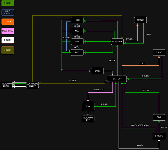

The past UI is simplistic.

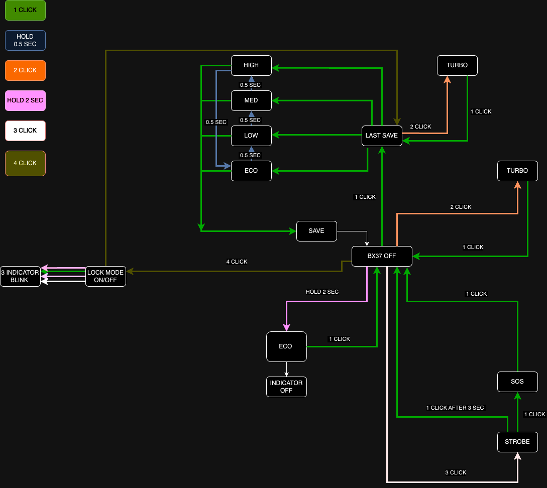

We used to want to use a more advanced version. Many things have been taken into account here. Here it is:
both UIs were designed by me.
That one is marginally better, but still some major issues:
- 2C should be a shortcut to turbo, not low
- Turbo is momentary only
- Strobe auto-exits after an extremely short time that IMO makes it useless for any actual defensive use (e.g. stunning an aggressive dog - last time I used turbo do that, it took me more than 3 seconds to reach my dog to get them off), and can’t be switched off without going through an additional mode if accidentally activated. It is especially useless for defensive purposes since it seems to exit to off instead of to turbo.
- Lockout has a weird shortcut
- No way to exit lockout to off, only to on
- 2 seconds is an extremely long lag to get to turbo even when momentary. A lot of usage of turbo (momentary or otherwise) is likely to need fast activation.
What you got right with that one:
- 1C on
- Lockout mode
- Shortcut to eco
- Indicator LED can be switched on/off
Overall, it’s more usable than the previous diagram, but still something that would cause me to recommend against a light.
It’s possible to have a good simplistic UI. Here’s a few start points:
- 1C on/off. 1C should always be to switch off when on, regardless of specific state.
- 1H to change brightness when on
- 1H from off for moon
- 2C for turbo (from any state except lockout)
- 2H for momentary turbo
- 4C from off for lockout
- 4C from lockout to switch on, or 3C to unlock and stay off
- Personally I dislike 3C for strobe, but that one is common enough that it’s probably fine to include too.

Thanks for the info. I’ve made some changes here based on your edits.
