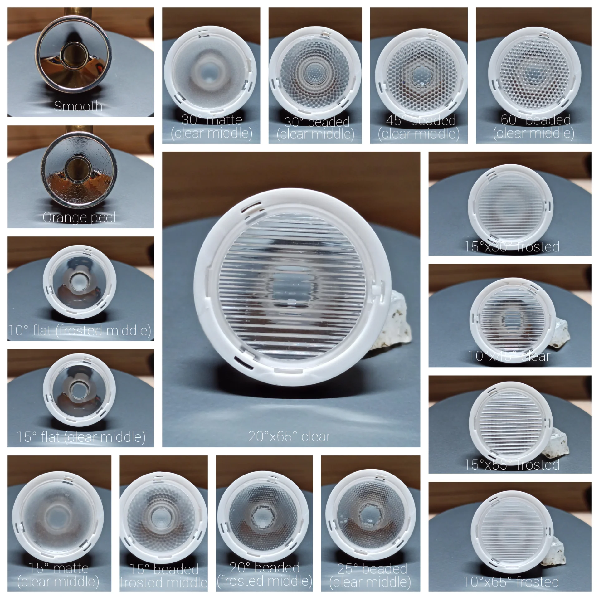

There is a variety of TIRs for this light to replace the reflector. If anybody has done it, what were the outcomes?

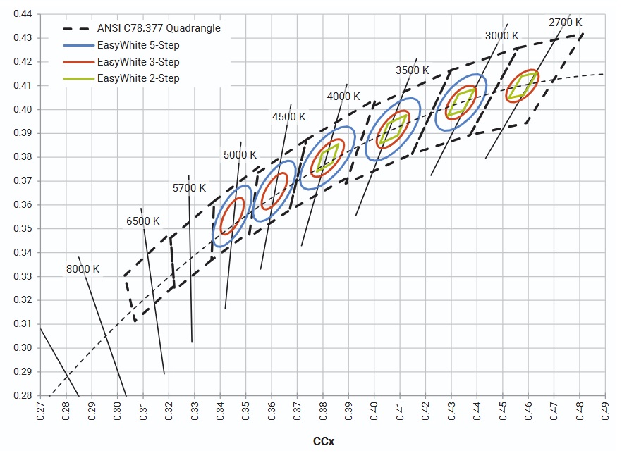

With the R9050 you have 70-80% chance to get one with green tint. With 5000K or 4000K 2-step even 90% (above dotted line=green):

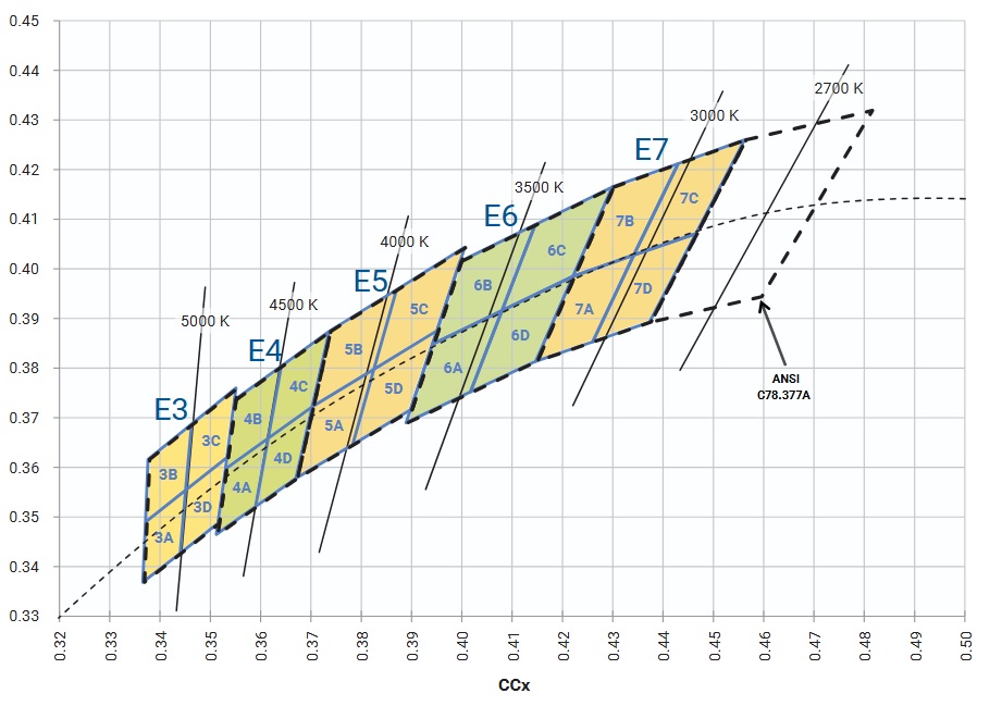

Meanwhile R70 is way different:
For example Convoy has 4000K 5D tint, it’s always either below (rosy) or pretty much at BBL (neutral) and never green. Not to mention it’s more efficient, we’re talking at least 700 lumens more at 3A. Color rendition may not be as perfect as high CRI Nichias but it’s better than LHP531, especially reds are more juicy despite both being low CRI. It’s a really nice tint with saturated colors but without brightness penalty.
Here are the outcomes for all of the S21E TIRs!
My personal recommendations are 15deg bead for throw, 30deg bead for throw/flood balance, and whatever wide angle bead for flood. I find that the 10deg flat has focus issues, and doesn’t throw visibly more than the 15deg bead. The 30deg bead has incredibly good angular tint uniformity, makes the beam rosier than most TIRs, and doesn’t make a hexagon beam due to the irregular bead pattern.
