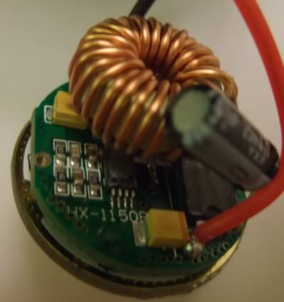

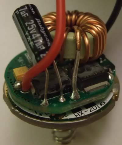

Oh for you modders, driver diameter opening is 26 mm. The driver uses a 26 mm contact board, bare, so looks easy to re-use for upgrading to a better driver. Easy to get out the driver from a retaining ring, extra wire length to pull the driver out of the pill, then a center screw is exposed which holds down the reflector (like many other multi-emitter lights - Shocker, etc.). Exposing the LED's reveals they are mounted on 16 mm stars epoxied down, nice centering plastic pieces, wired in series. Soooo perfect to mod!!
I'm definitely thinking XML U3's on 16 mm SinkPAD's, and the driver, maybe the 3.5A IOS custom - 2-3 cells, 1-3 LED's...

Can these driver be modded for more current?

Finally got to modding my STL-V2. I had the driver for months laying around. I now get 3.9A measures at the tail, and 2,764 lumens OTF at 30 secs.
This is really nice now - like the feel better than a SRK, and this throws pretty well. The driver is no longer sold at IOS, but that's where I got it. Simply lo-med-hi, but well regulated. This light has a solid one piece design - no separate pill, lot of aluminum.
Mods: driver replacement (26mm rated for 2.6-3A per LED), 22 gauge wires, XM-L2 U2 1C's on 16mm SinkPADs, pill top and stars sanded to 2500 grit (mirror like finish), AS5 under the stars, DeoxIT Gold on contacts, coper braid driver spring, 50mm AR lens installed (stock lens is 51.7mm but it fits ok). The AR lens added 85 lumens.
