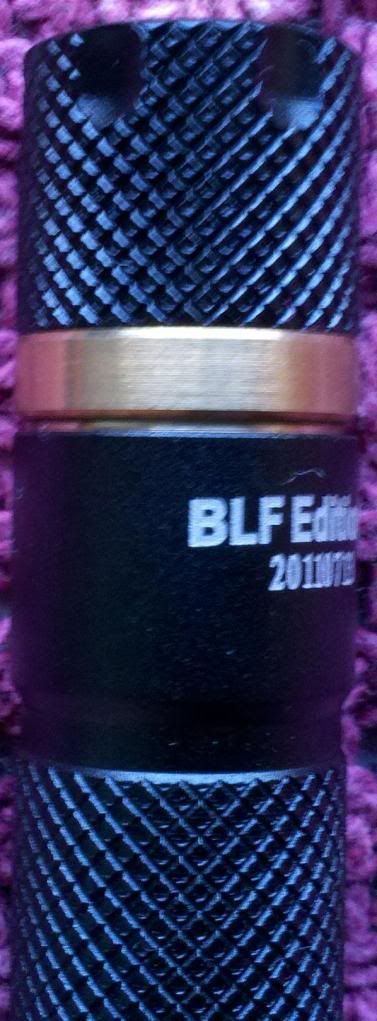

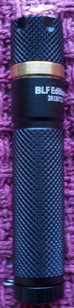

Here are a few pictures of the issue. I don't own any 14500 cells so I can't speak for those. But the pictures below are with an Eneloop inserted. It's about the same with a some junky chinese NiMH cells and with standard Alkaline cells. As you can see, the gap is minimal, doesn't seem to affect functionality. I wonder about water resistance though.
