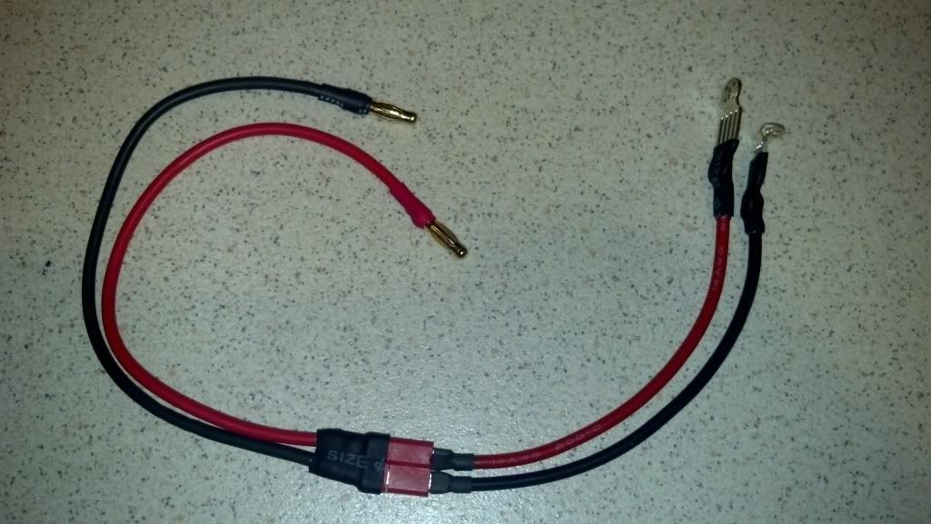

My 980L arrived from Manafont today, and all I can say is that I’m very impressed. Actually, that’s a lie. The other thing I can say is that I think I need a better DMM. Truth is, I can say quite a lot of other things actually, but let’s just focus on the matter at hand.
The highest reading I can get with my DMM is 3.3A. But it fluctuates all over the place, and that’s even with solder braid tightly wrapped around the contact points. But ceiling bounce tests against another XM-L light that I have confirmed draws a steady 2.9A (at least with my DMM in the circuit anyway) demonstrate something that a mere additional 400mA wouldn’t account for. The 980L is noticeably brighter.
UPDATE: OK, wow. I can’t quite believe this. I rigged up some new leads for my DMM. Like so:
The charger lead (14 AWG) I had already, and the plugs are compatible with my DMM. From the female deans connector onwards is 14 AWG wire with battery bars soldered on to the ends. I bent the one connected to the negative lead at a right angle to facilitate a good connection with the battery terminal.
Guess what I’m reading now with a battery hot off the charger? Between 5.5 and 5.8 amps. The reading still fluctuates a little, but it’s steady within that range. People have said that making some better DMM leads would make a difference, and I believed them. But I just didn’t think that the difference would be this significant.
FYI
Further fun and games ahead.
(put some decent leads on your DMMs guys, if you haven’t already!)
FURTHER UPDATE: Since I have a cheap DMM, I wanted to make sure that it wasn’t throwing out bullshit values. So I managed to hook it up in line while running some battery discharge tests with my hobby charger. At 3, 4 and 5 amps it matched what my charger was reporting to within 10-20 mA. So I am satisfied that these readings are accurate now.
