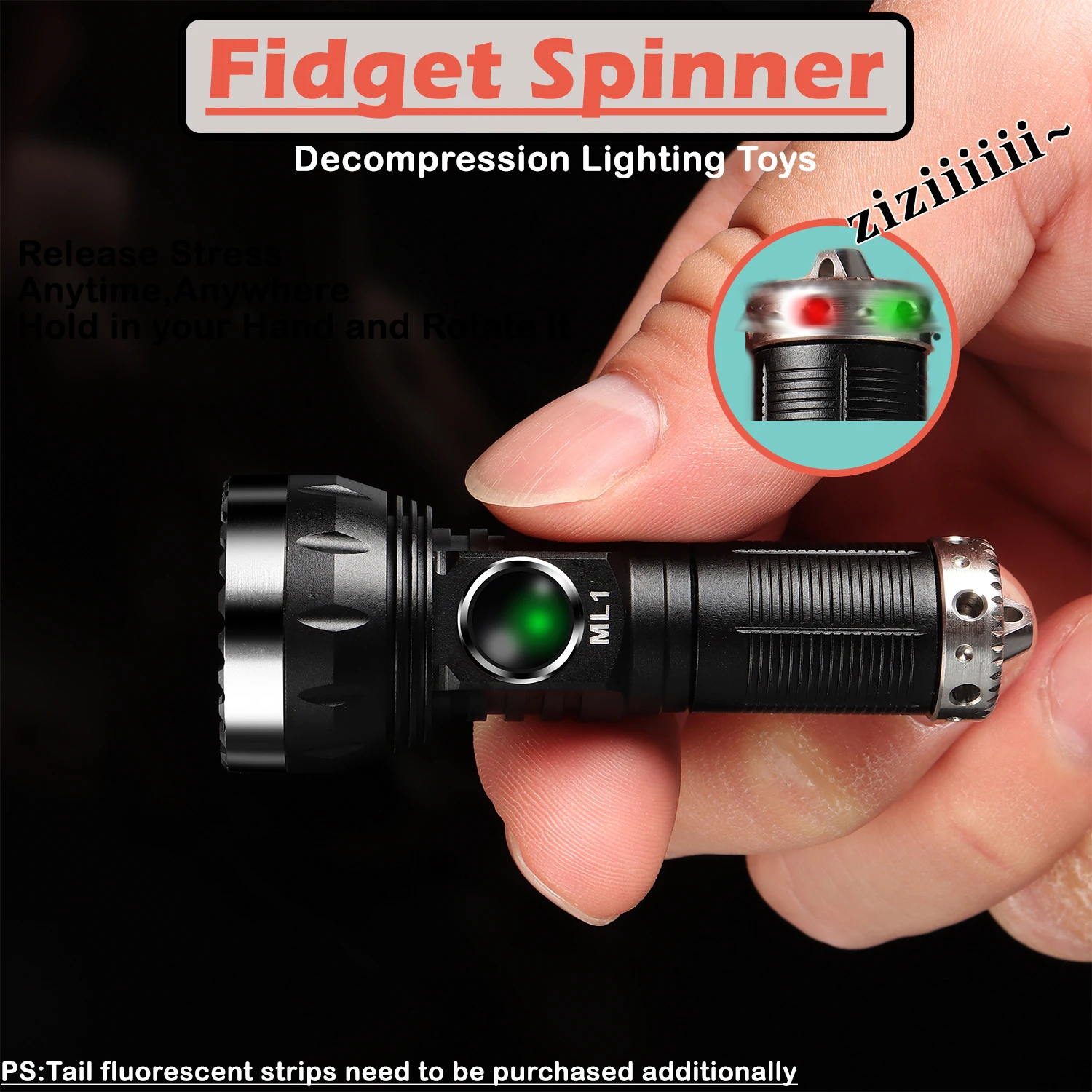

Funny you should mention that brand… I came across a light on Ali the other day which someone came on here asking advice about making (for the life of me I can’t find it now) but it had a fidget spinner on it…who knew it was an actual manufacturer lol!
Yes, we are a new brand, but we were mainly OEMs before, so not many people know about us.
