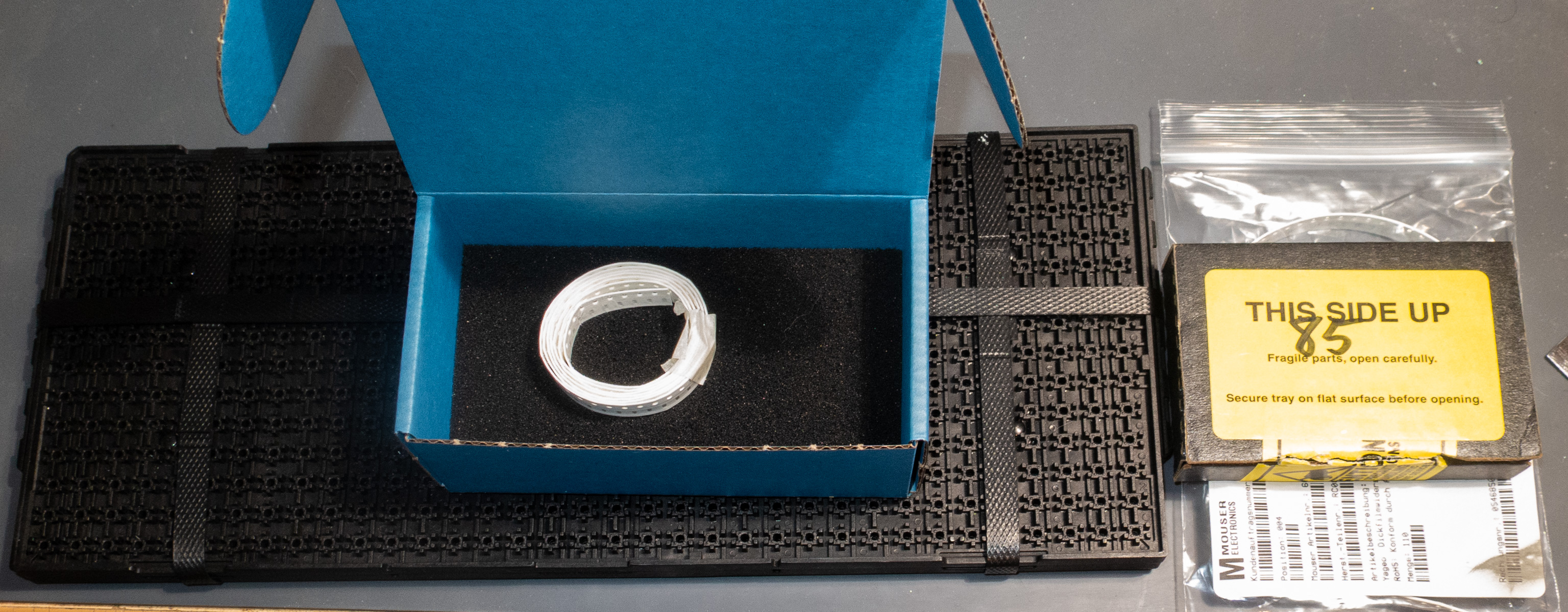

Arrow going crazy on component packaging and shipments
Long story short
I ordered parts for around 52$ for free international express shipping
3 Parcels now, one Netherlands, one USA and one China
all with Express shipping and DDP, 2 times DHL one time UPS
and they even pack 200 47k resistors I paid 23 cents for in a box likely more expensive in a single parcel
and for 10 Attiny in MLF package a whole tray used
Much more efficient when ordering from Mouser, MLF in a small ESD box and any non ESD stuff in a zip bag
Yea, Arrow packaging is so ridiculous that I don’t even want to buy things from them. You wouldn’t believe the massive stack of boxes on my porch and all the plastic trays I had to discard just for a smallish order of chips and leds and stuff. The resulting pile of trash was actually guilt inducing. They have to be losing so much money and it makes no sense.

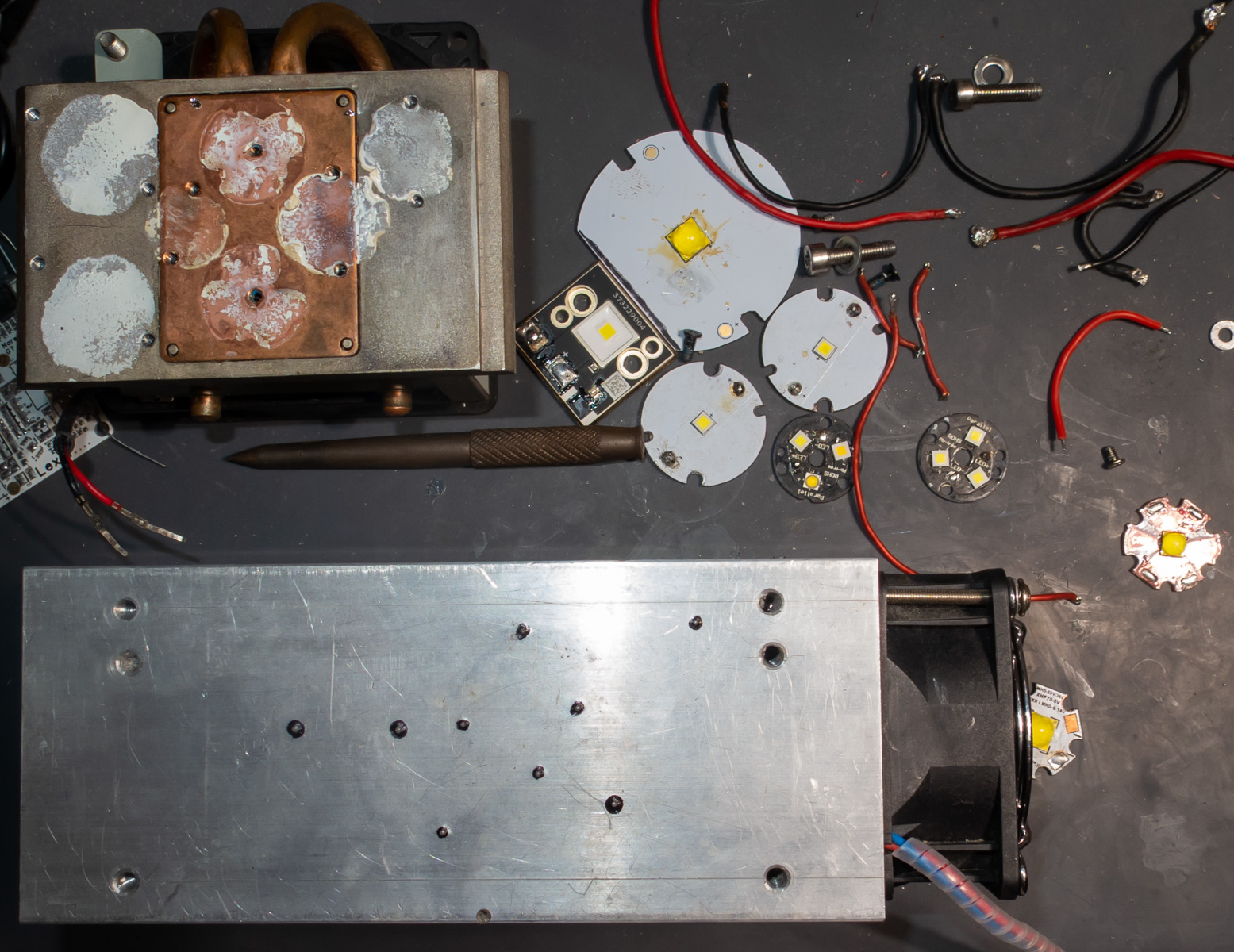

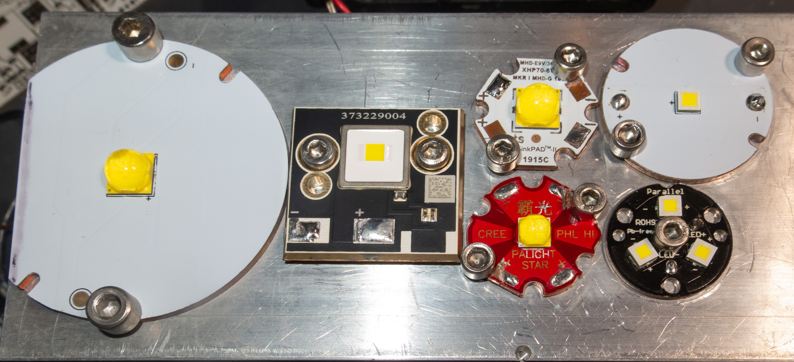

Made a new LED block for testing driver
As I had often dust burning my domes I wanted to seal it
upgraded the heat sink significantly in thermal mass and cooling power using a used air tunnel cooler that has a solid 10mm top plate
Disassembling old and marking the new holes, had already soldered the heavily stressed 12V XHP70.2 to a Lumintop GT MCPCB

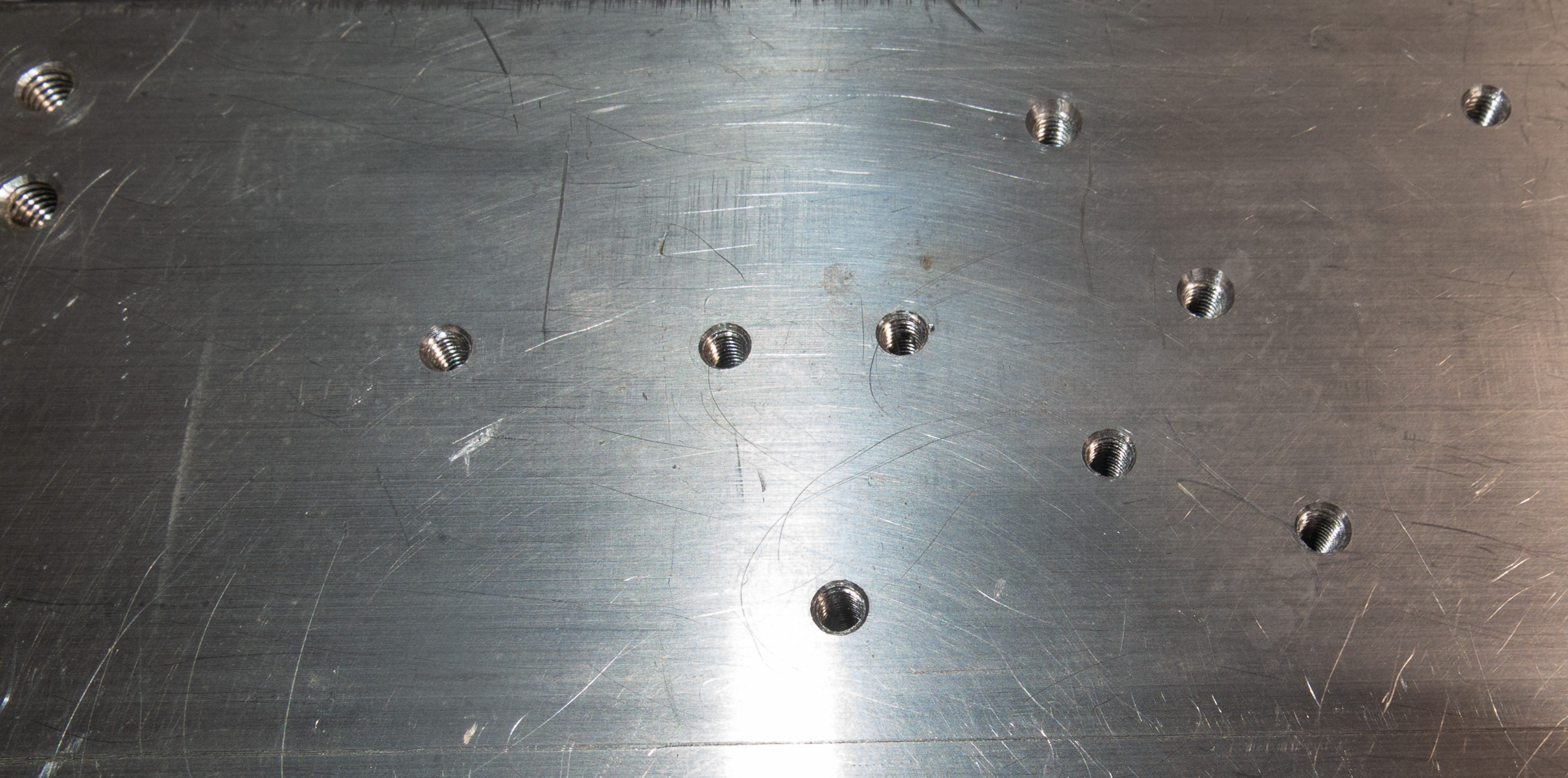

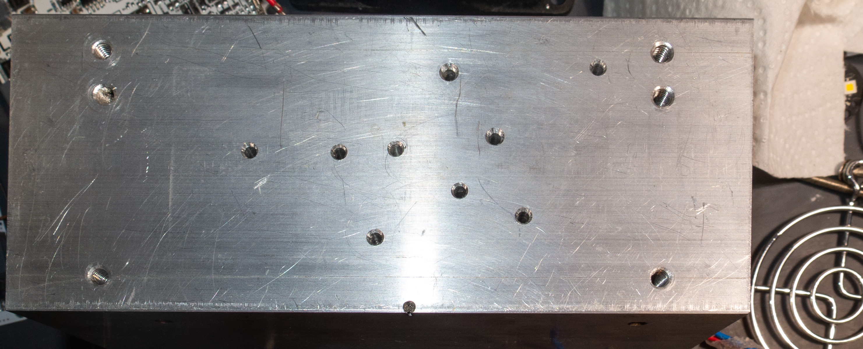

Holes drilled and a bit sunk

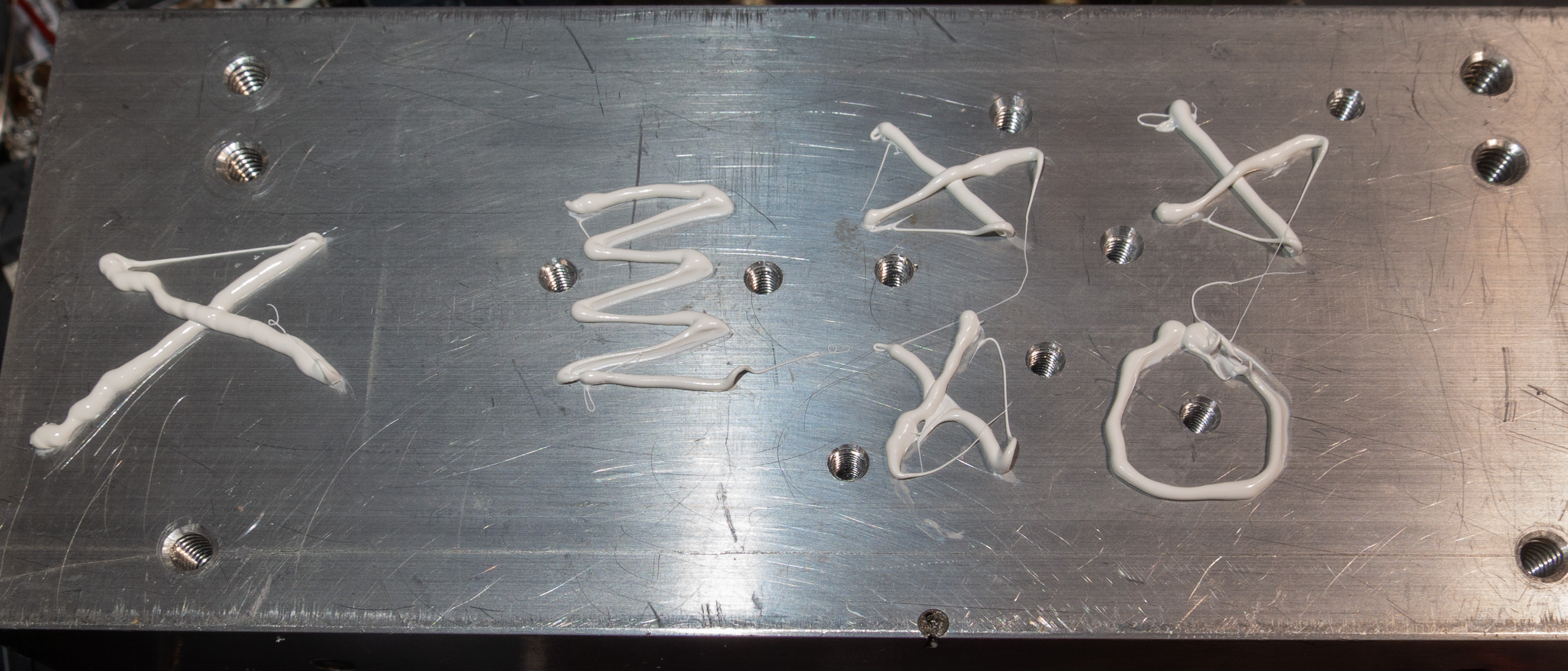

Cut threads and applying thermal paste

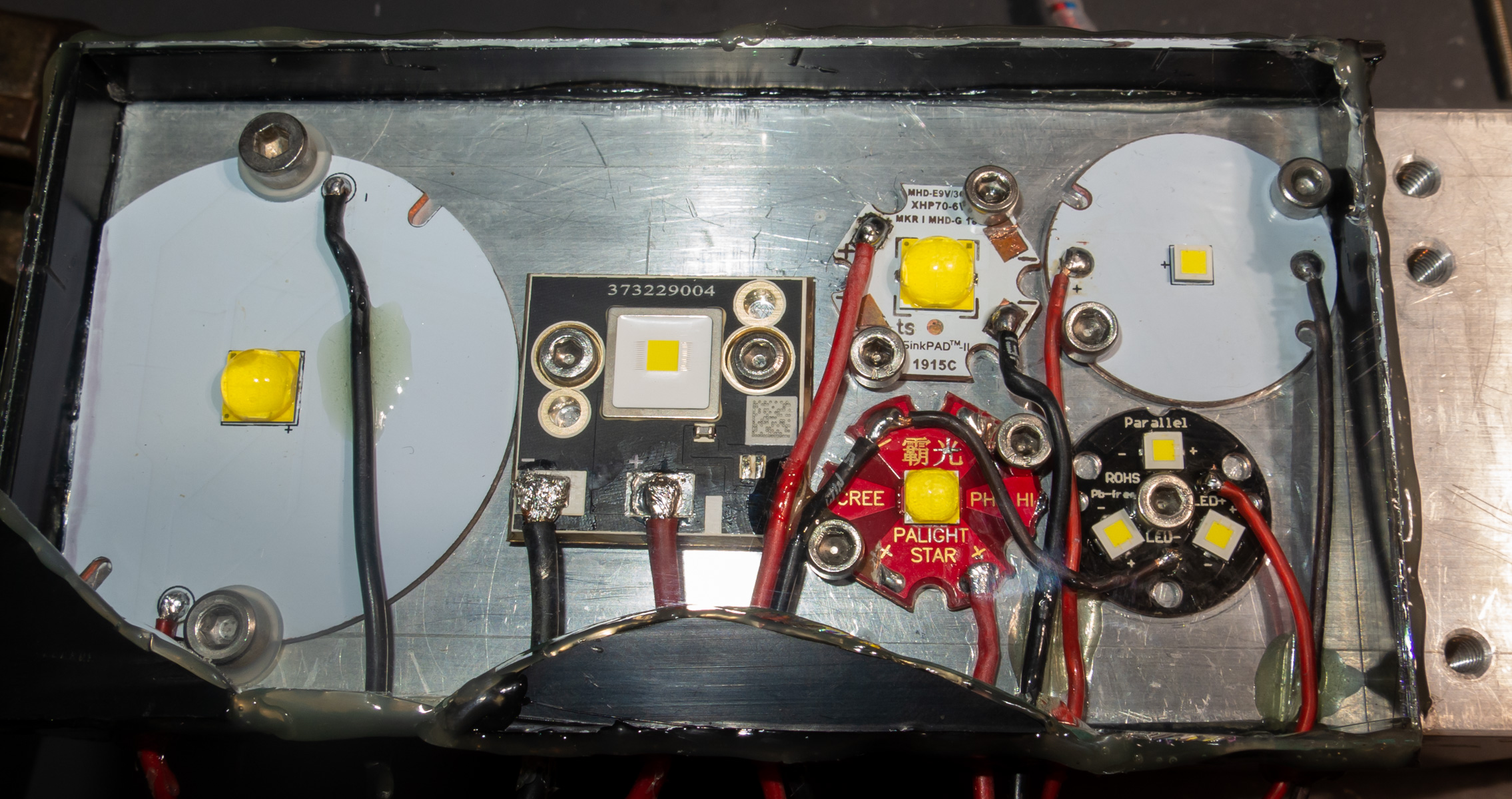

MCPCBs prepped for good contact
MCPCBs mounted
Tried to cut a piece of AR glass lying around didn’t work so well, used hot glue to put all together
Very cool, just keep in mind that using the notches on the edge of the mcpcb is not going to press down near the center like a reflector will. I’m a little worried about that xhp70.2. Maybe its massive size is good enough to keep it alive.
I pushed the MCPCB around the LED with like 30kg a couple of times and the paste came out on the left side where I cut a bit away from the MCPCB
I cleaned all the pushed out thermal paste with alcohol and tooth brush, all the MCPCBs had quite some paste pushed out
