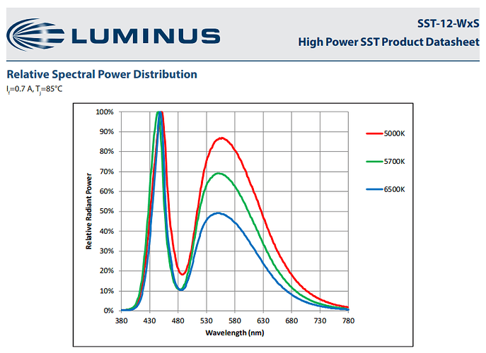

Really small led with high cri and compatibility with often used 3535 sized accessories could be Luminus SST-12 in 4000K? Neutral bin available at least from here
I think this is probably the best option. Small emitter, very high CRI, and good compatibility with all sorts of optics. Also, can just order one on a MCPCB already so no reflowing required.
Forgot about this! If maximum output is not a priority then this is the best option for producing a tight beam.
Thanks for that link. I like how small it is, and also how cheap. The datasheet spectrum seems to show quite a dip around 480-500 nm, but I guess that’s just the way it is with these devices.
That’s the wrong datasheet, WxS is the cold white 70CRI version.
WxH and WxH Gen2 are the ones you need.
…sorry, you did say the 4000K version. I see the SST-12-WxH at 4000K does have
a much better looking spectrum, so that looks like a winner to me.
Oh, looks like we both sent the same pic at the same time ![]()
