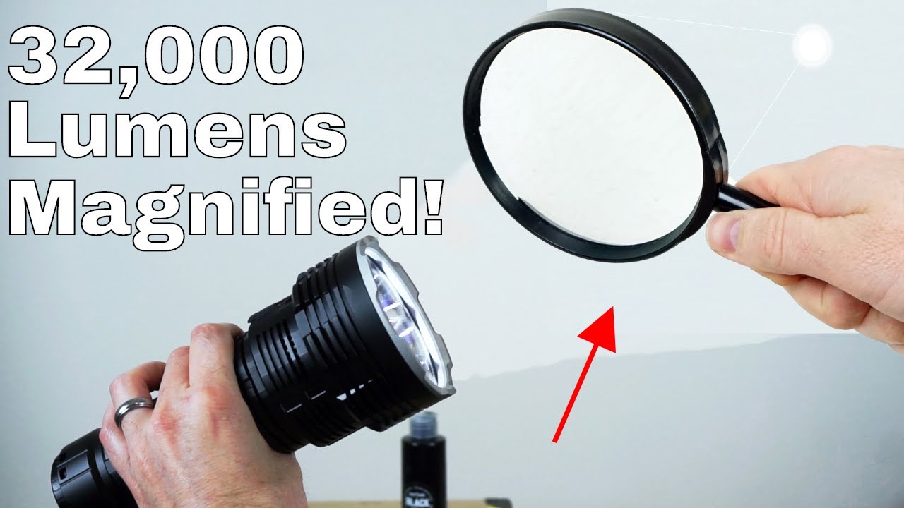

This guy here made a nice hotspot but unfortunately its not good for eyes right? And for peephole too
Magnifier:

I dont see anything harmful ini these vids as far as eye health goes. Its just white light, not UV.

Hand holding a lens infront of a flashlight to create a hot spot seems totally impractical, so does re-purposing a waste basket to try and become a flashlight. (LOL!!) I doubt anyone on BLF would recommend either scenario. If that’s your goal you are better off with a BLF-GT or similar huge reflector thrower.
As far as being “good for the eyes”… It’s simple, Don’t do it if it causes discomfort. Discomfort is your bodys way of telling you to stop. Looking directly into any of my lights hurts so I don’t do it. Others may disagree however.
