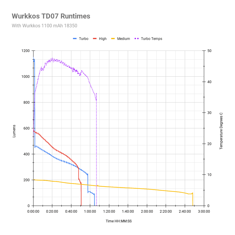

But ultimately runtime will be shorter on Turbo and High, and longer on Low and Medium output. So its up to you to use an output that makes the battery last longer, or not.. this is true for all lights
runtime concerns are mostly solved by having extra batteries..
otoh, in this chart you can see that Turbo and High (Red and Blue lines) last about an Hour, but notice the output is not steady, it continuously goes lower.. for me, that is not good, and is a reason not to buy it
but, if its a light that interests you.., get it and have fun with it.. its not that expensive.. for more runtime, just get more batteries…
