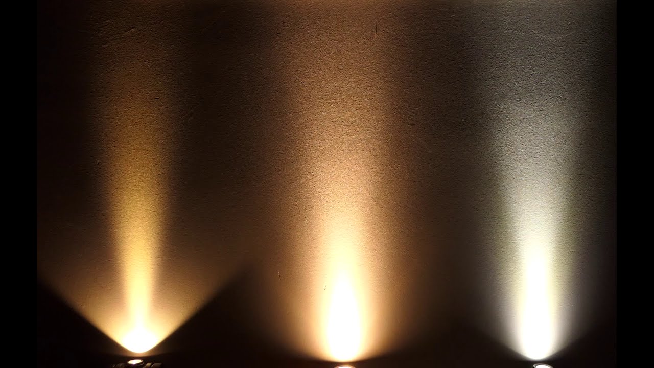

After reading this tread about about month ago I ordered the IF25 because I don’t mod lights and this one looked pretty fascinating to me. I’m not usually bothered much by tint and usually stay in the Cree 3D, SST-20 5000k range when I buy something so I wanted to see what this was like.
But I’m really liking the low end 2700k indoors on the IF25 and since I’m in and out a lot at night it’s really great to be able to use the tint ramp outside to go up to the 6500k range. I’m not noticing much green at all when in the 6500k range. I compared to other SST-20’s I have and this IF25 actually looks about the most white without much yellow or green.
