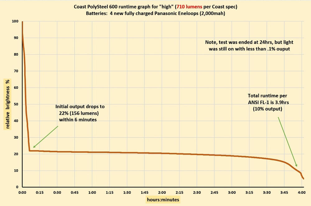

Yep, my Polysteel 600 is the worst example I own of extreme down-regulating:

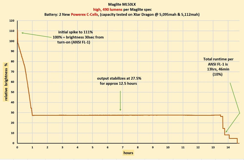

Don't have that many Maglites, but that's a pretty close observation on one I do have (ML50LX);
