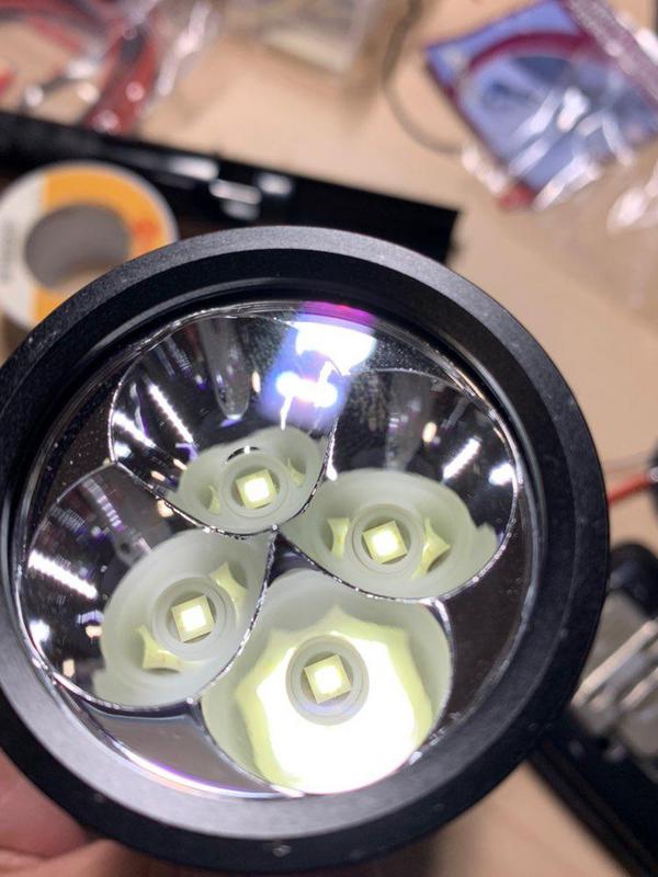

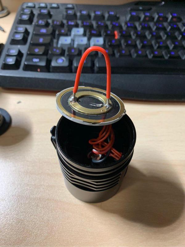

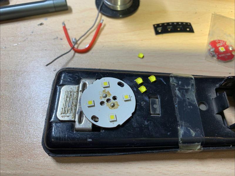

I managed to remove the driver and swap the leds on my SP36, I put four XPL-HI V3 3C 5000k
I’m seeing 3800lm and 450m. I was expecting a little more
however the beam is much better and also the tint

I’m glad the loop method worked for you. My driver was not glued back because it sticks in well enough by friction, how is yours?
My SP36 has sliced high CRI LH351D leds and makes even less light, around 3000 lumen. This output I think suits the size of this light well enough.
I’m glad I went all good tint and high CRI, but the 5000 lumen stock setup is also a nice one, and tough to improve.

My driver also sticks well without adding glue again, it’s a tight fit
I prefer the beam of the HIs rather than the extra lumen from the XPl2, but I was hoping for more than 500m (the sofirn Q8 makes 700m)
