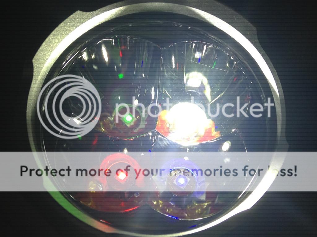

A T4 will be my first test host for my RGBW driver running tterev3’s MELD UI, cant wait to get the parts and get it built. The end goal of the project is a EDC’able RGBW light but the T4 should be pretty bad ass for testing plus running 3x 4.35v cells should be able to stay in regulation a good amount of time.

I used bondo on the one I build with MELD for a customer. Been a long time since I had to bust out the bondo lol.
