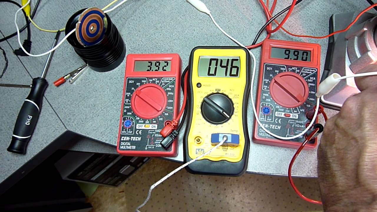

The meter on the left is reading the voltage of the pack. The yellow meter in the middle is measuring the temperature of the star. I placed the thermocouple right up next to one of the LEDs’. The meter to the right is going to measure the current to the star. Because this is a direct drive hookup, I knew that the LEDs would be subject to thermal runaway and wanted to monitor that. It is hard to see the star as in this pic it is edgewise, but you can see the orange clamp that is holding the thermocouple. Here is a picture of that connection. The little silver blob to the right of the LED and under the yellow tab is the thermocouple.

Notice the current goes up and the temperature increases. I only let the star go to 50C as it is not sinked and was rising fast. Anyway about 10A. I believe the limiting factor is the copper traces on the star, probably some resistance there. Here is an angle shot of those traces.

Once again, about 10A

Dchomak, first of all I want to thank you for taking the time to post your test findings. However, I disagree with your findings. That 6x XM-L2 MCPCB will pull FAR more than 10A on four good cells. In fact, I would be very surprised to see less than 20A on four good cells with heavy wire to the MCPCB. Mine pulled 13.2A from a single 18650, with the stock skinny wires, over 10A from a single IMR 18350. I am guessing that with 18AWG wire it will do 16A+ from a single 18650.
Something in your test setup is adding a lot of resistance.

I was very aware of how resistance in the circuit could impact the results, that is why I set it up so as to try and eliminate any possible points of resistance. As you know, it only takes one bad connection to cause a problem.
If that is the case, then it could be the alligator clips, banana jacks or even the cells themselves. Voltage at the pack dropped 0.2V after the 10A draw, so the internal resistance of the 4 pack would be .02 ohm or 20 milliohm. Times that by 4 and you get 80 milliohm per cell. Is that about to be expected for that cell?
I am pretty sure that XM-L2s will draw less than an XM-L with 18650s in direct drive. But you are right in expecting much more, so was I. That is why I immediately suspected the traces on the MCPCB.
The light is back together, I will try a test later with nothing but solder joints at ALL connections, even the meter. With the driver in place if the current goes up, then we know.
Actually, the current draw in the video is slightly higher WITH the driver than WITHOUT. That means something is amiss here. This is a case where if I am wrong about the MCPCB, it would be GOOD news. I would be glad to be wrong about that.

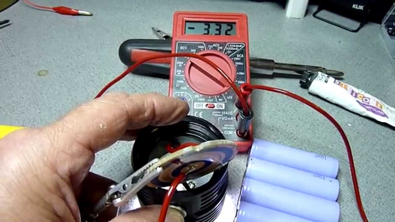

Direct drive to the MCPCB with the stock skinny wires and a single cell.
The 0.2v drop isn't much at all, actually. Especially since those are 4.3v cells which unless I misunderstood you've only charged to 4.2v. Even so, you should be seeing much higher number with that, especially with 16 AWG wires running to the MCPCB. Even with those cells charged to 4.2v I would expect 18A+ out of of that setup.
I have my test leads (a pair of 18 AWG on each plug, not sure if that's still as much as a single 12 AWG but it's enough) soldered directly to the jacks of my DMM (also a red HFT like yours.) I noticed that at 6-7A my banana plugs would start to get pretty warm, so I got rid of them. The only reason I don't try and measure more than one cell is that I am pretty sure it will pop my DMM, I ruined one once trying to measure 4 20Rs into 3 XM-L2s...I need to get a 30A ammeter for these big multi-cell parallel lights.
