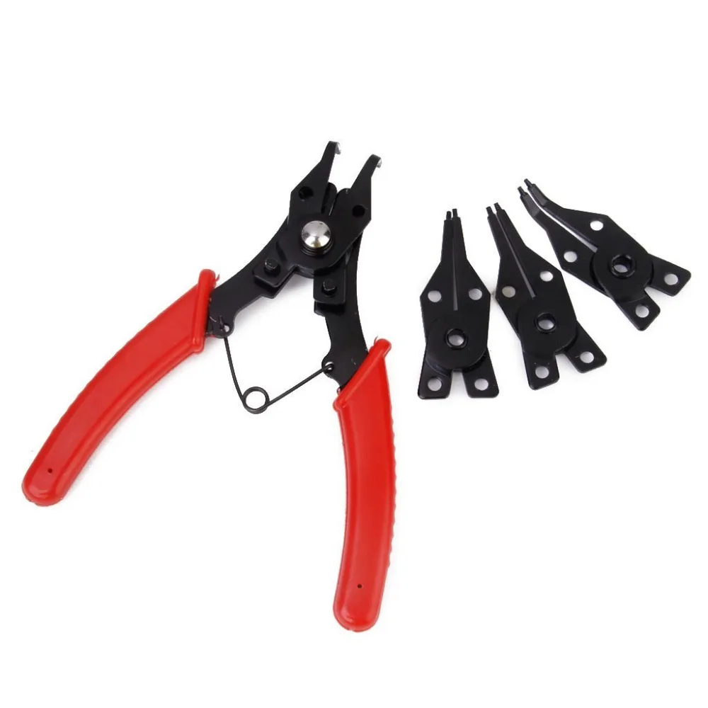

I’ve got 2 of those……hate them. They can work but are quite poorly made and the changeable jaws are a real pain.
My father in law died 15 years ago, he was a mechanic specialized in lawnmotors. he could make nearly anything (if it werent fine mechanics) he made me a very nice tool cart (from old materials) filled with several of his tools, and they included the solid snap ring pliers, which work very nice.
So i dont have any experience with the interchangeable ones, if you are looking for quality, you should buy these;

The holes on the retaining ring are tiny and most circlip pliers are to fat to fit in the grooves. You could make the holes bigger but its a brittle piece on aluminum so it will probably snap or morph.
I have broken some then you have to solder the driver in place.
