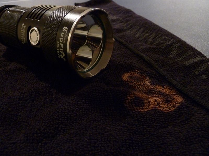

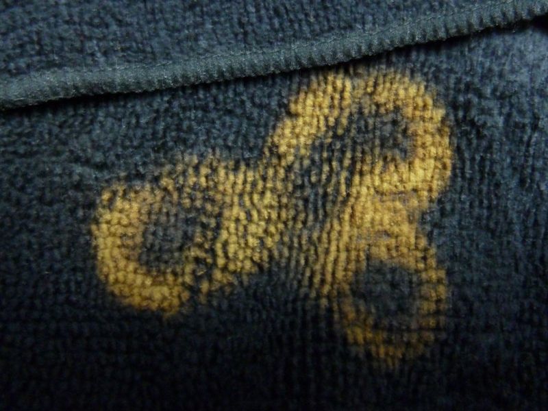

I prefer no thermal reg too, but this happened to me. Before there was a Q8, a popular SRK style light to mod was the SupFire M6 w/3 LED's. It accidentally turned on in my bag one day on the way home from work, where I had it wrapped in a towel.
The Q8 was actually based on many of the characteristics of the M6. This M6 was so hot, I had to poke at the switch a few times to get it to turn off - it was too hot to handle and took at least 20 mins to cool off. Amazingly enough, no damage to the batteries, LED's, drivers - no damage or noticeable loss of performance. With the right MCPCB's, LED's, wiring and design, it's pretty spectacular how much heat these things can really take.
I've had other incidents too. Even with a 2.8 amp driver in a Convoy S2, the heat can get untouchable in a few minutes if you leave the light standing on it's own.
