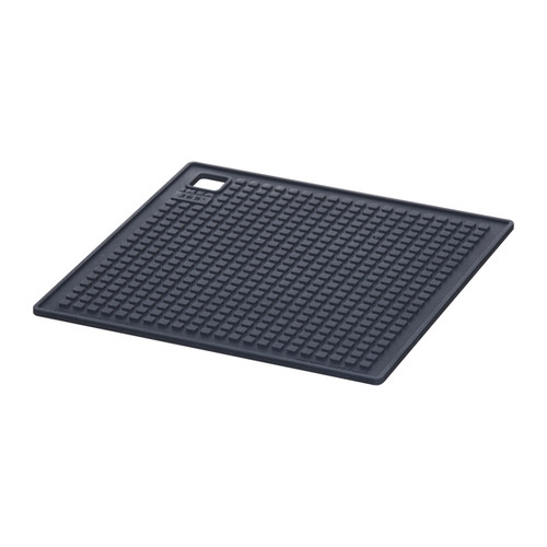

Never heard of anyone injuring themselves while removing a flashlight bezel. Must be seriously tight!
ToyKeeper found that a carpeted floor can be a big help. Push the light bezel first into the carpet and twist.
I have a section of 1/2” thick floor cushion, the stuff they put at a work station to stand on. Kind of a foamy rubber. I use that to press the light into and grip the bezel, works quite well.
I used the back of a mouse pad for traction, but all I could see it doing was ruin the mousepad. I don’t have any carpets around here, but maybe I can find an ESD rubber mat.
I seriously thought the bezel was glued, but looking at the reports here it was just tight, very tight.
