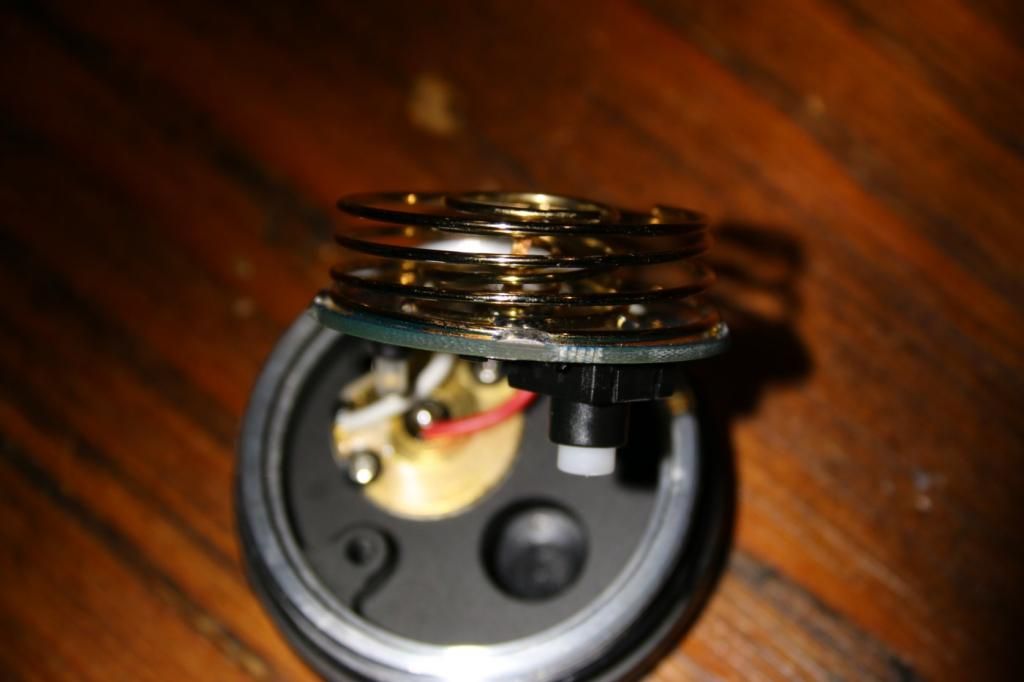

Ok, so I dedomed the LED, braided the springs and upgraded the driver -> LED wires and it all works fine except it won’t turn off!
All the modes work correctly etc but it won’t shut off via the tailcap switch, only if I turn it to standby. Any ideas what could cause this?!

I assumed there must have been a short somewhere. I have doubled checked all the springs and there is no shorts anywhere. I only use 1.5mm braid and I run it down the middle of the spring so it doesn’t touch anything else. In the tail cap I only did the centre spring not the outside ones.
Check continuity in the tailcap to see if the current breaks when you click the tail cap. perhaps your bypass is working correctly but the heat you used melted the switch?
Edit: Also sounds like what happens when the small spring inside the switch overheats. It won’t press the switch components apart to turn off or break the connection.
I will check that out. The weird thing is clicking the switch still turns the battery indicator light in the tail on and off. That makes me think the switch is still operating correctly?
Check to make sure the tail cap isn’t somehow contacting the back end of the carrier or otherwise bypassing the switch. That’ll do what you’re describing as well.
I have tested it by unscrewing the tailcap completely and just pushing it on until the springs make contact with the carrier and it still switches on. This really has me baffled, I have done the same mods to two K40s, TN31, TN30 and a TN35 and have never had an issue. I wish they hadn’t introduced this in light charging system and had just left it as a normal tailcap switch without all the other circuitry.

I’m really hoping someone might know what is going on here. I have been looking at this switch for two days now and can’t figure it out and I’m just baffled as to what is happening. The switch works perfectly, tested continuity across it and all works fine plus the led indicator on the tail works with the switch, I have looked for any sign of a short anywhere and can’t see anything, I even lightly filed down the spots of solder on the outer spring to ensure they couldn’t come in contact with the body. I have tested it by using some leads with alligator clips with the switch outside the light and it still won’t turn off so it is definitely something in the switch board itself. I have taken a whole bunch of pictures from different angles in the hope that someone notices something that I haven’t… Lastly when I was soldering I was hardly getting any heat into the board, I used a hot iron, touched it on and straight out again, the board was fine to touch immediately after and I have done a ton of braided springs on drivers etc now and never had an issue from getting it too hot. Pics below…

Have you tried undoing everything you did already? ie. remove the braid, extra solder, and any other modifications. If so, what was the result?
