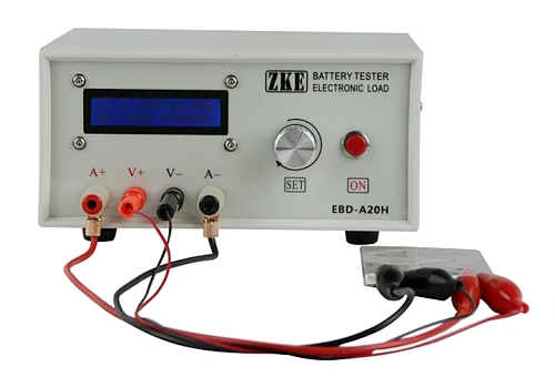

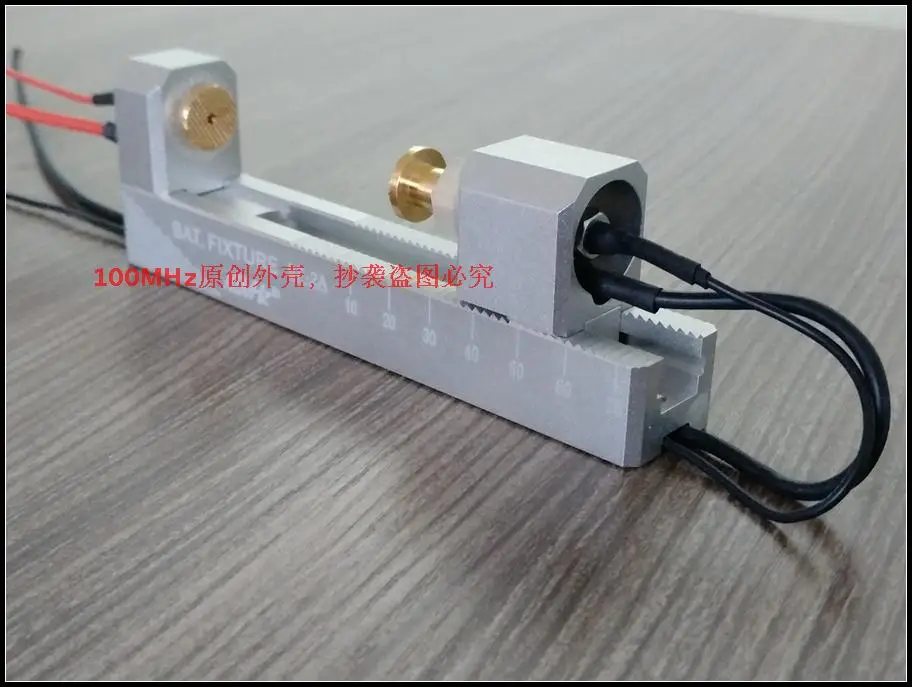

I used to test the batteries I bought with EBD-A20H (an electronic load for up to 20A discharge) and a 30A version BF-2A (a 4-wire battery fixture).
