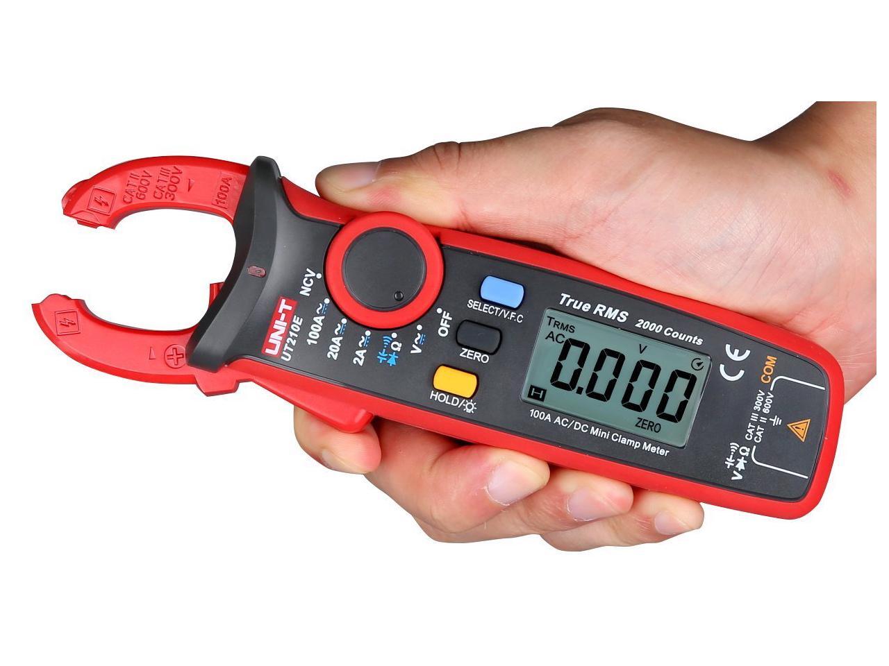

At the end of the day it’s all pretty irrelevant as a standard multi-meter is not going to read higher amperages true anyway. The clamp meter is what works here. The UNI-T UT210-E like we bought in the group buy is the way to go. A lot of us here bought this meter so we’d all be on the same page in current draw readings. It can do up to 100A, which at first I thought was pretty ludicrous, but I’m finding these days that I need that…
With a clamp meter, you simply run a reasonably thick wire from the tube to the rear of the cell to make continuity and use the clamp around the wire to read the current. Break contact with the wire to shift modes, the wire is your temporary switch.
