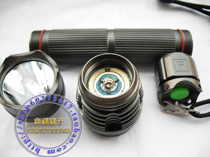

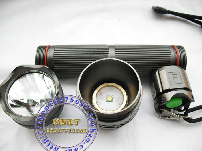

Other details from TaoBao:
This light definitely exists in 1x26650 format. In this photo the 2x26650 tube is in the background.
Priced @ $33
The 2x26650 version is sold for $36 by the same seller.
Shipping is $1.5 in China. :)
