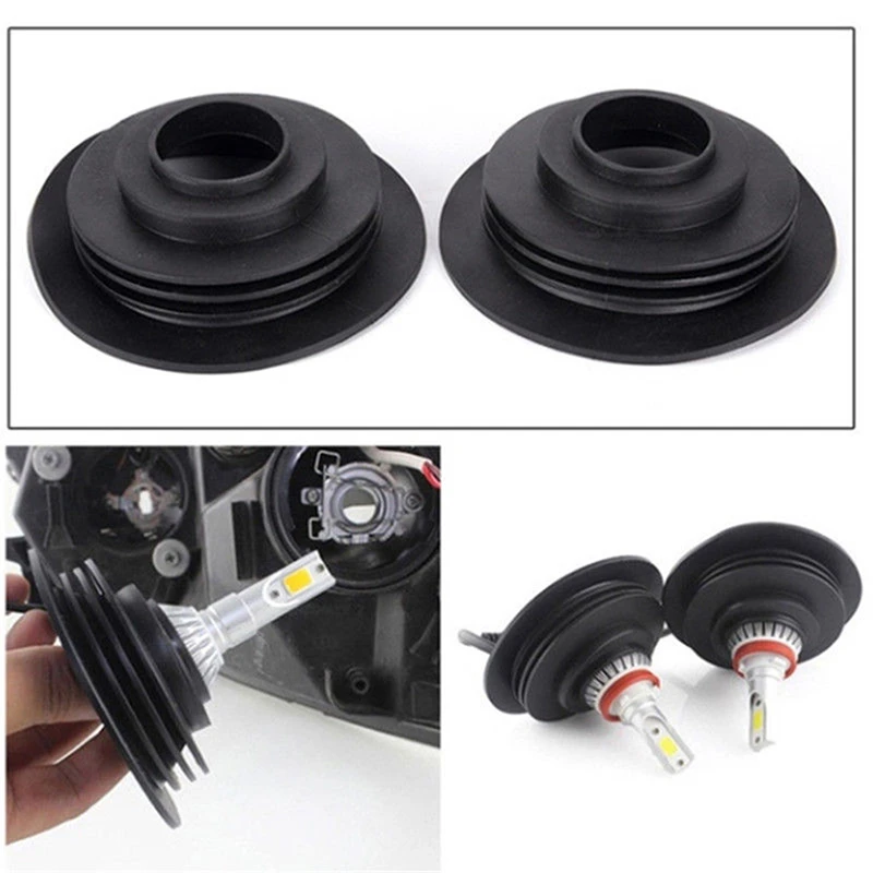

There are protective rubber headlight cups (universal and even the aftermarket one that can replace OEM part all over aliexpress).
One example of universal:
Edit:
Guys if you will order any type of car LED bulbs you got to have on your mind that you’ll probably need a rubber dust cover if you don’t want to mod your original one.
So I will install this Magic Crystal bulb once when I receive “protective rubber dust covers” on slow boat from China
. Why I did not think on that when I ordered this LED bulb in a first place? ![]()
I don’t want to destroy my OEM rubber cup with sharpie so I will rather wait for freaking replacement rubber cup from China…
