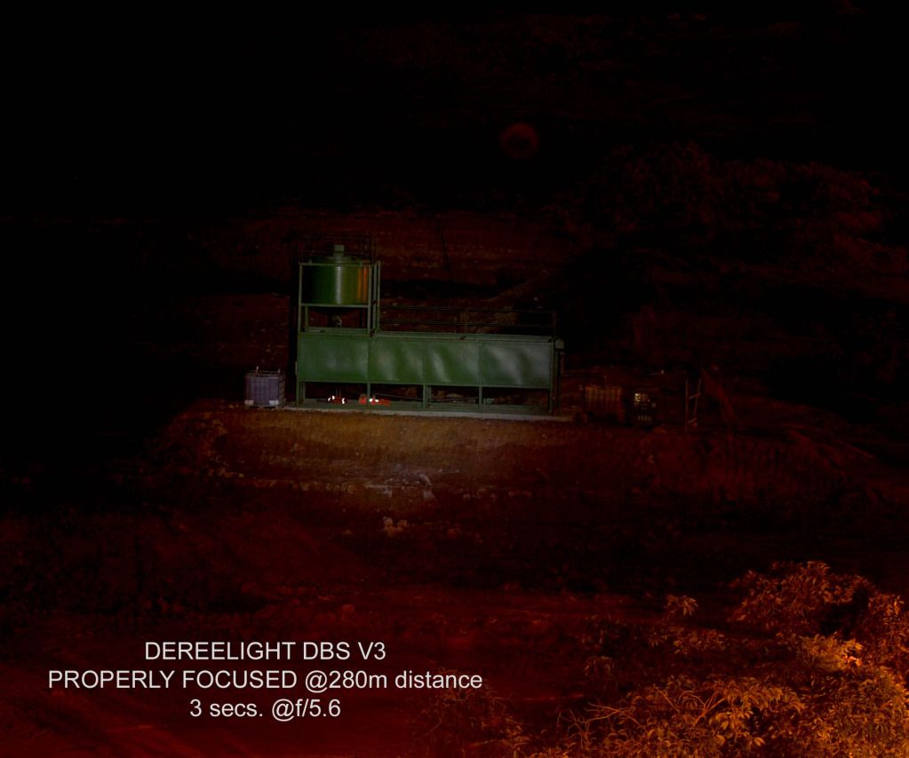

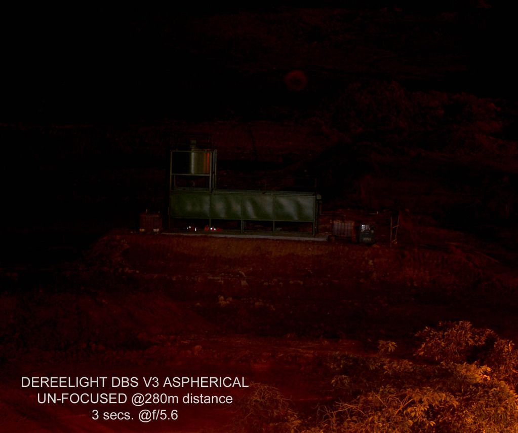

BTW, do confirm that you are going to focus it correctly. You can try with 50m targets, good enough. Just get a decent die image. +/-4% in lux doesn't matter, your eyes are NEVER going to be able to register the difference, just on the lux meter only.
Just troubleshooted a local flashaholic's DBS aspheric EZ900. Originally it was lousier than the STL-V2. LOL! He took my advice to get the Dereelight DBS, so i panicked a bit too.. hheh...
Actually I think you still can get a sharper die image. Look at mine...it's pretty sharp/defined...i mean the edges. It is supposed to be the shape of the XM-L emitter.
