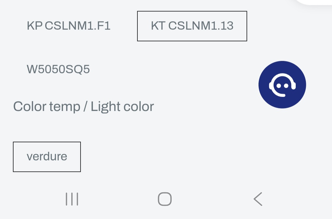

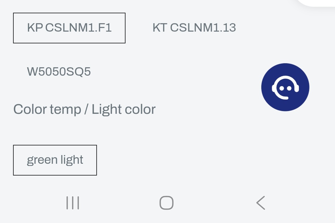

What is the difference between these two leds? They are both green so… Is one more preferred than the other?
There are others who will be able to better explain this, but I’ll tell you what I know. These might also be known as W1 green.
The .F1 one is just a regular green LED, and with its beam, you will still be able to see the colors on objects. It has very bad CRI, but you can still tell colors apart. It is very slightly a yellowish green.
The .13 one is narrow-band green, not sure of the wavelength. It might appear to be slightly darker or deeper green. Since it’s a monochrome emitter, you will not be able to tell the colors apart of whatever you are shining it on.
I have both the CSLNM1.F1 and the CSLNM1.13, although I have not put the .13 into a light yet. The .F1 is amazing in a light with a big smooth reflector like the Noctigon K1 (what I have) and it is very intense. When I ordered it, that was the furthest throwing LED available. I’m not sure if the narrow-band .13 version would be more or less intense.
Edit: my profile picture here on BLF is my K1 with the CSLNM1.F1 led, just to give you somewhat of an idea on the color.
