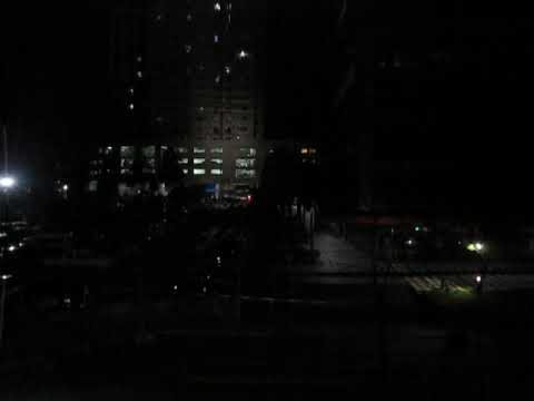

User DTA has made many beam shot videos of lights at fixed distances. We can probably find the right led once we know the distances. I’m waiting on his response.
Here is his video of the Convoy L2 with the xhp50.2.
I don’t know the distances in the video, but maybe it gives you a good visual idea of this reflector/led combo.
