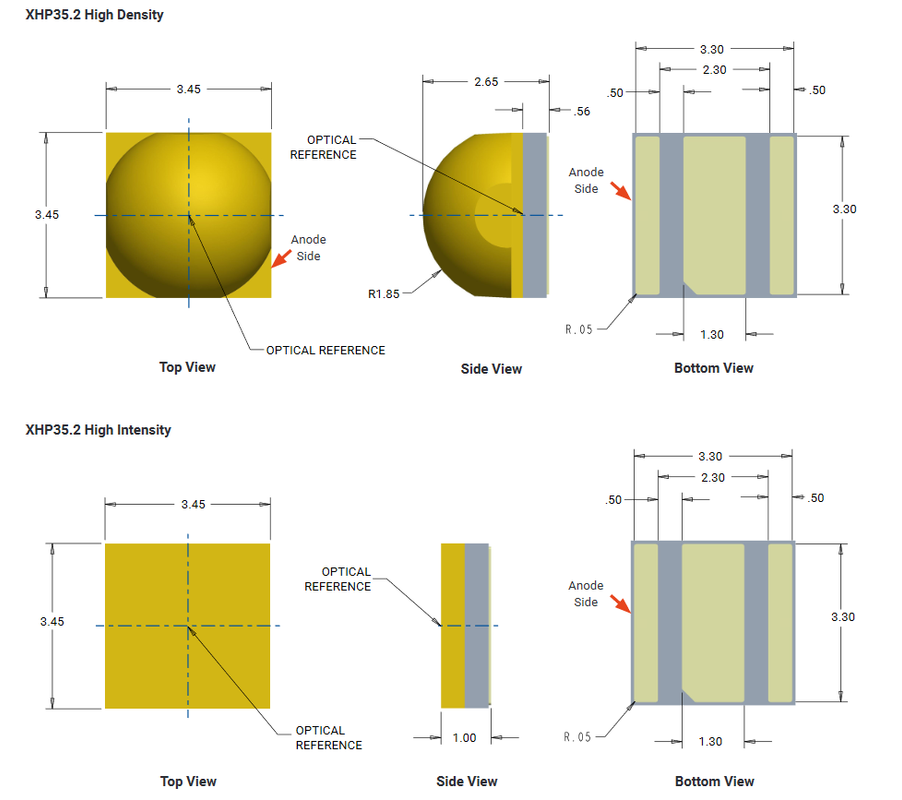

The XHP35 is 12v only. I know the XHP70.2 can be 6v or 12v (depending on MCPCB) , and I’m not sure for the 50.
Page 28 of the XHP70.2’s datasheet ( https://cree-led.com/media/documents/ds-XHP702.pdf ) show this image of the bottom pad where you can see that the outside pads are split to allow for more than one configuration. This allows the XHP70.2 and the XHP50.2 to be configured as either 6v or 12v.
Page 35 of the XHP35.2’s datasheet ( https://cree-led.com/media/documents/datasheet-XHP35-2.pdf ) has the following image which shows that the same pads are solid which means it is a single configuration only, in this case 12v:
You’re right, the answer doesn’t specify why the driver would work with the 70 and not the 35 as it’s possible for a driver to work with both.

It seems you have this figured out now. I’ll add a little bit more.
In order for the xhp35 to be tightly packed, Cree actually joined the edges of the core in such a way that there are no wires connecting them. See below.
This gives them virtually no gaps between the cores and you get a better result (tighter beam, less artifacts). There are only 2 electrical contacts on the rear.
The xhp50 and 70, on the other hand, have the cores separated. The 50.2 and 70.2 have the same gaps, but the yellow phosphor is just spread all over minimizing the gap appearance.
It’s cores are wired such that 2 of the cores are in series and the other 2 cores are in series. You then have 4 connectors on the back. The MCPCB is what determines if it will be 6v or 12v. It can connect the 2 series cores in parallel for 6v or it can connect the 2 series cores in series and you get 12v.
The newer 3v version of the XHP50.2 has the cores internally wired all in parallel and only have 2 electrical connections on back. This is why it’s 3v only.
Keep in mind that these 4 core leds (xhp50 and 70) are basically just 4 smaller 3v leds combined. You can see the combinations in the second picture I posted.
