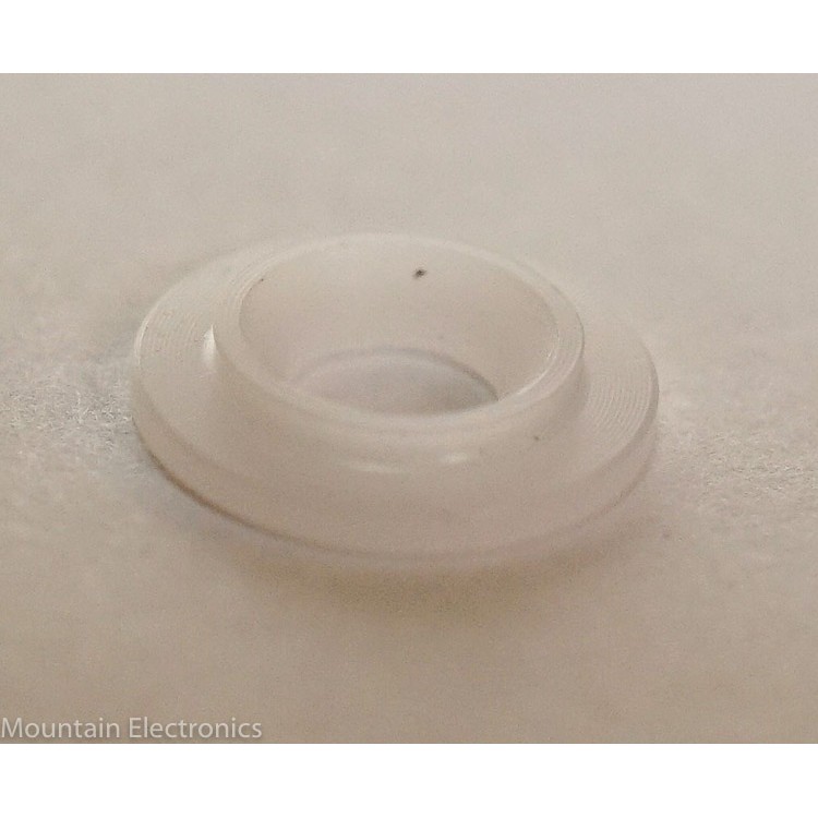

An explanation of the parts:
If you take the bezel off you’ll see the lens and an oring. Remember how they are arranged. Then the reflector is sitting on top of a smaller plastic piece called a centering ring. The reflector centers on that. Then the hole in the centering ring is supposed to center around the led. It looks like the hole is just a tiny bit too large in your light which allows it to not center perfectly every time.
The pressure of screwing down the bezel presses down on the glass, oring, reflector, centering ring and mcpcb. This pressure is what allows good heat transfer from the mcpcb to the flashlight head. The mcpcb might have one or two screws going through it. These are usually there only to prevent rotation. Tightening the bezel might rotate the reflector and it could cut the wires if the mcpcb were to rotate.
If you unscrew the bezel and remove the downward pressure the parts should be able to move around a little bit.
Here is a typical centering ring.
It’s also called led insulation gasket or a reflector spacer.
