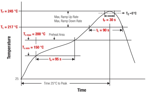

My solder paste has not arrived yet, but trying to solder back the removed led using original solder and additional flux did not seem to work as well. I think removing component requires significantly lower temp than installing. So, I think I need to apply more heat. However, since hotter air can potentially damage dome or other weak part of led I think it makes much more sense to apply heat from the bottom and closely monitor the solder.
Today, a cheap hot plate ($4) I purchased was delivered. Reflowing was much quicker and easier. The cheap hot plate was able to reach over 200C (it stabilizes around 250C) in less than a minute. Using it, I was able to reinstall the previously removed led using existing solder with additional flux paste. I understood right away why using a hot plate is much easier. By the way, I had to unplug the hot plate pretty quickly because when the plate reached over 200C the reflowing was already done. I was able to check the boing (in the famous video by Matt https://www.youtube.com/watch?v=B3F68ubfBkk ) and was able to push out extra solder after the plate was unplugged. It was $4 well spent! I have also ordered a small copper block that can be attached to a soldering iron, so I think I can use that to slow down the heating. Thank you for the tip!

Itâs possible that your emitters used lead-free solderâŚthat takes more heat and usually takes significantly more heat on subsequent melting. Flux does help but lead-free can be a bear to work with. The usual 63/37 leaded solder is great stuff, and itâs eutectic so it solidifies instantly when heat is removed (thatâs nice when youâre working with fiddly connections or in a cramped flashlight head)âŚhas a bit lower melting temp, too, 183C or so (and generally find that I need around 220C or a touch more to desolder that, depending)âŚwire or paste, either way.
