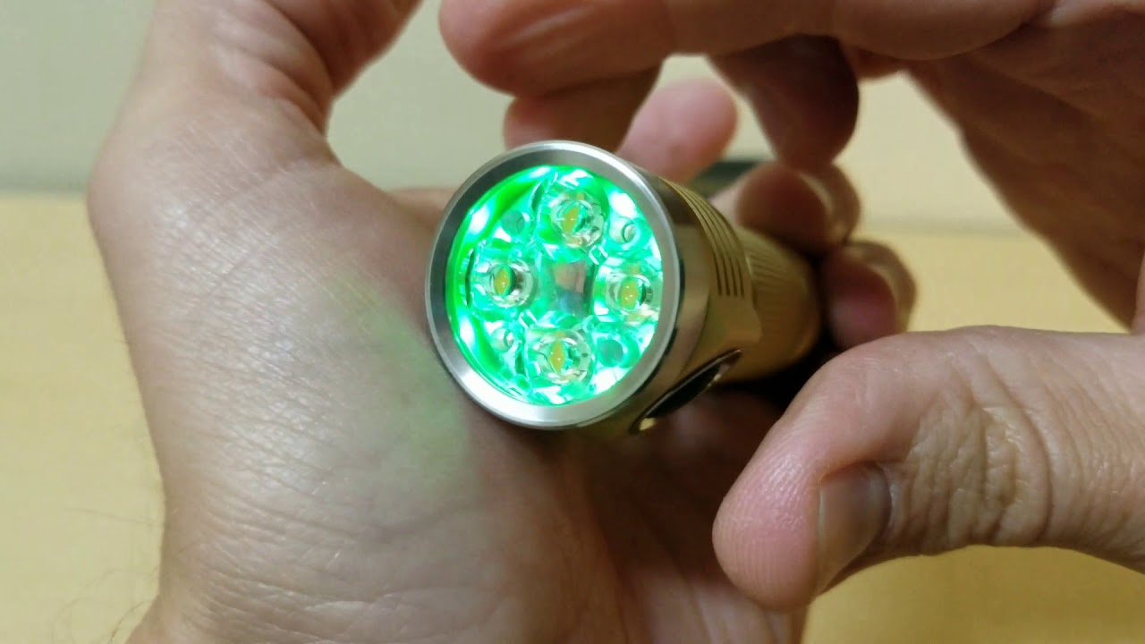

The rainbow mode was originally 0.5s per frame, but people thought that was too fast so I changed it to 2s per frame. However, while finishing up the KR4 firmware, Hank asked me to change it back to the faster speed. Not sure why, but I’m guessing because it’s more eye-catching.
There’s a setting in the config file which can set the speed per config. Use one of these lines:
#define RGB_RAINBOW_SPEED 0x03  // 0.5s per color
#define RGB_RAINBOW_SPEED 0x07  // 1s per color
#define RGB_RAINBOW_SPEED 0x0f  // 2s per color

Been eyeing these alittle while now, just so many cool features to these.
The colored leds, am I seeing those runtimes right?
That on low, you could basically leave it on a color, as a locator light so you can find the flashlight in the dark, and ,well, just to look cool, and its pulling virtually no significant power?
On low, is it only visible in the dark, or in a room with lights on also?
On high, do they offer any significant output? Or still just for looks?
For example, could I use them as a small amount of accent color lighting when taking a photo of something?
The UI looks decent, but there is so much to it, cant get it all in my head with just the diagram, is there a good video showing the UI?
To answer some of my own questions, found this video.
So the colored lights get bright enough to see in a lit room, and to read by in the dark,
but not bright enough to actually cast any color on a subject when taking photos in a lit room.
Oh well, still a really cool feature.
