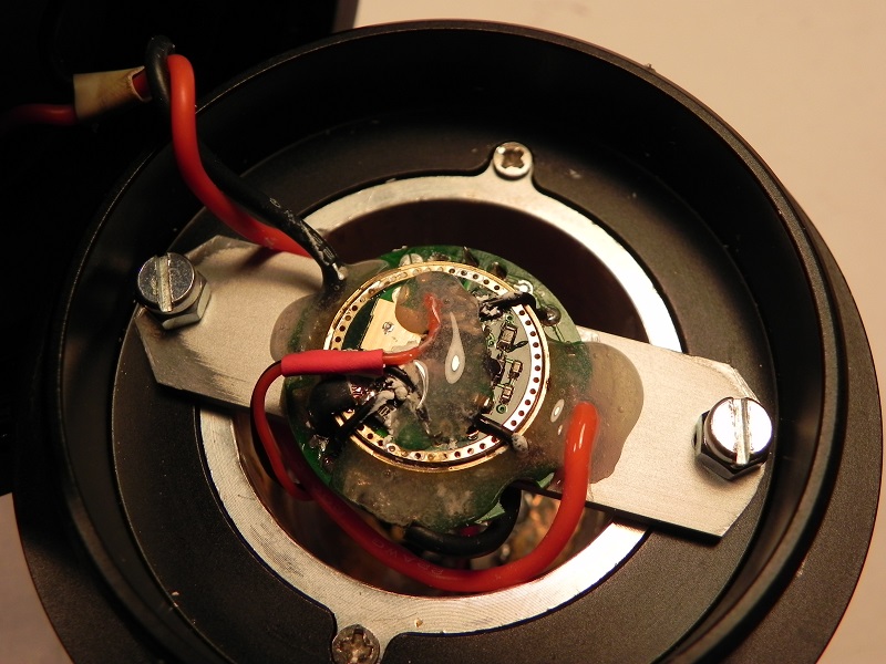

just a little update. After almost three years running XP-G2 dedomed something had to happen. So i removed the old LCK 5,7A Driver and pulled the LED. I used a 4S LD2-M2 2,5A which was placed on an aluminium bar in the huge pill. I use 4x Efest 26500.
Then i glued the ends of the wires with epoxy.
The nice XHP35 Hi 5000K
The light now makes about 2200 Lumens and 562 Klux (~1500m range) :slight_smile: Much less intensity than before (>800 Klux) but it is unbelievable useful now! Very broad beam with a medium corona.

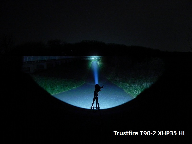

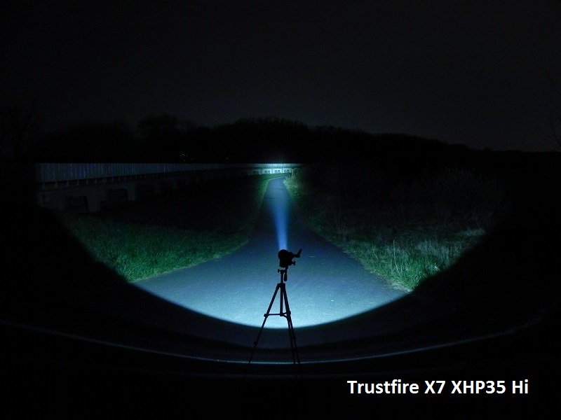

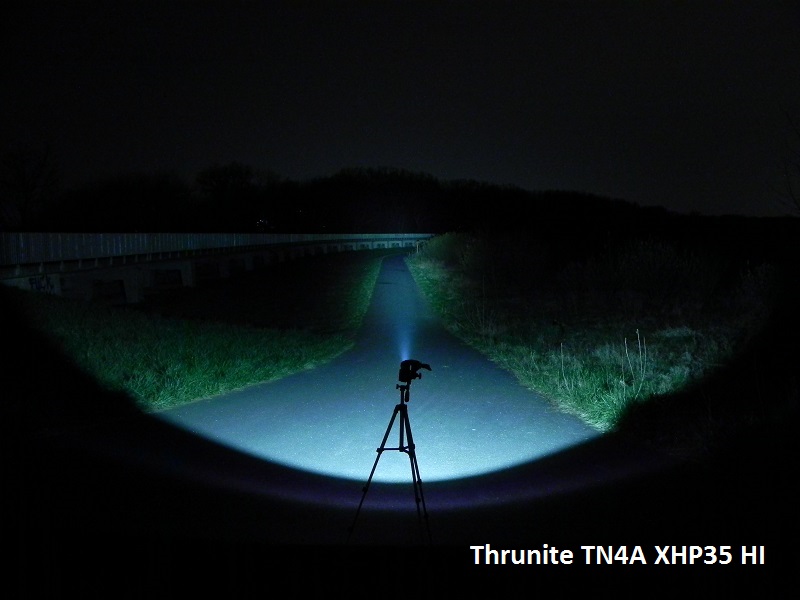

Hi,
here are some beamshots of the Trustfire T90-2 compared to Trustfire X7 and Thrunite TN4A, all running a XHP35 Hi at 2,5A.
Controlshot
Trustfire T90-2 - 562 Klux, 2400 Lumens
Trustfire X7 - 334 Klux, 2400 Lumens
Thrunite TN4A, 77 Klux, 2150 Lumens

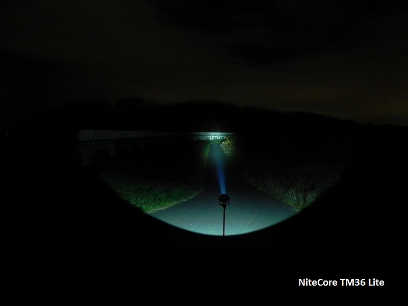

Here some older shots for comparison
