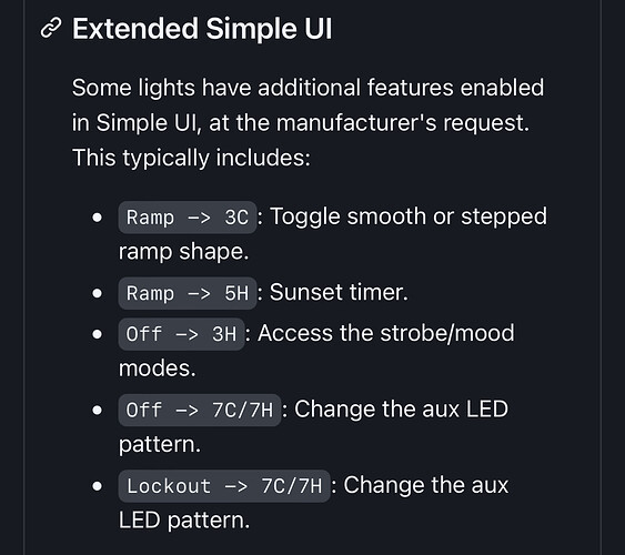

In attempt to clarify @litris’s position (even though your comment isn’t necessarily directed at them), their adult kids and family want to use strobes and @litris wants to give them access to strobe, but does not want to have to hand them a complicated manual or have them asking for help when ending up in a random menu.
One solution would just be telling them to unscrew and rescrew the tailcap to get out of any momentary mode or menu. This likely will get some eye-rolls and those people will be less excited about it. Also they could still certainly accidentally change some random setting, or even accidentally hold a button while screwing it in and reset it.
Adding a way to access strobe modes to from Simple UI via some configuration or UI change as linked above would solve this. Or if they always wanted strobe one of us could just build them firmware with Extended Simple UI, but that would require them to have a flashing kit and always want strobe in Simple UI (and thus it wouldn’t be as safe to hand to younger kids)

I have looked that the latest version supports or so it seems the strobo mode in Simple UI by configuring it.
But it keeps it with the 3H more complicated for the initiated.
For me the 3C is ideal for strobo and easy for everyone.
