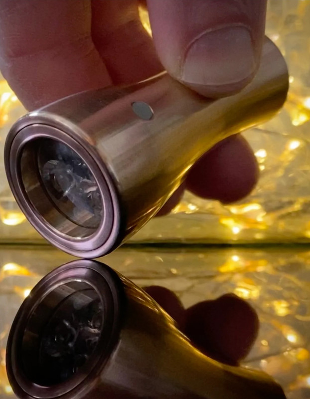

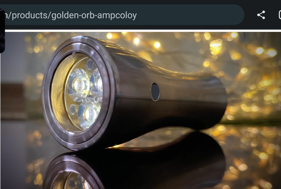

I'm really intrigued by the use of Ampcoloy (BeCu) as an ideally suited functional exotic alloy for a flashlight. Here is one with a Lux-RC programmable Nichia 4000K light engine:
https://orrbott.com/products/golden-orb-ampcoloy
HDS systems also did an anniversary run of BeCu lights and has it presently available. For four figures.
From the alloy manufacturer:
AMPCOLOY® 83 is an exceptional high forgeability and machinability beryllium copper. It's engineered with exceedingly high mechanical properties in mind, resulting in superior thermal conductivity, improved cycle time and mould life – up to 50% more when compared to Copper Titanium.

BeCu could be a good material for the head of a flashlight. Depending on the alloy it is very flexible and springy, so a lot of thin cooling fins could be carved, making a huge cooling surface.
I suggested this once to Sofirn, but never heard anything about it.
It is not that easy to work on a lathe, though, because of fumes, and it needs a surface treatment to avoid formation of poisonous patina.
